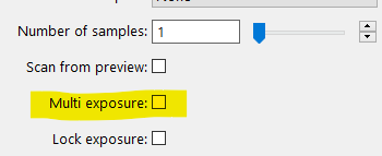

What might help you, though, is a feature of vuescan (possibly present in other software) called Multi Exposure, whereby the image is digitized twice: (a) with a moderate exposure limited by not "burning through" the transparent parts of the film, (b) second one with a longer exposure time and/or higher analog gain, to improve the signal/noise in the opaque parts; the two exposures are then combined into a single digital image with a higher dynamic range than might be achieved with either one alone. Need to store the result as 48-bit Tiff in order to reap full benefit.

Not to be confused with "Number of samples", that combines a number of identical exposures to improve signal/noise; less effective IMO.
