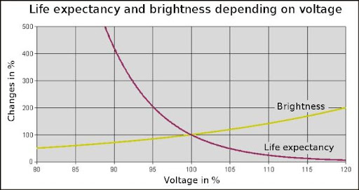

Do you have a voltmeter, have you verified by how much the voltage changes during the day or from minute to minute?
That does look like a regulator that you could use for an enlarger, but realize it would only limit a spike to 127V (from 120 nominal).
Also, according to this generic diagram, you would need a 20% increase in voltage to get one stop more exposure.
10% increase is 1/2 stop, 5% increase 1/4 stop.
So that 6% spike that the device can manage is only about 1/4 stop change, and that assumes the spike continues through the entire exposure.

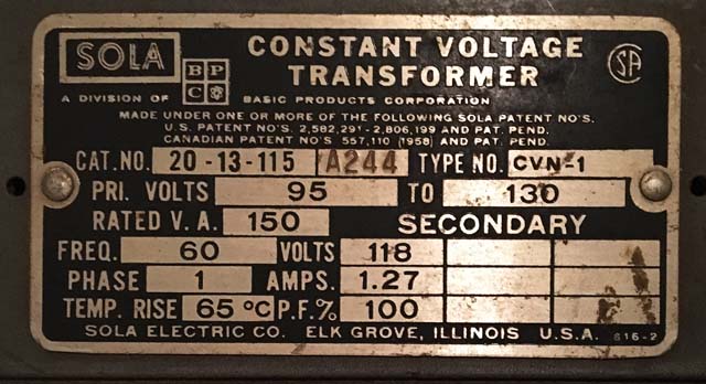

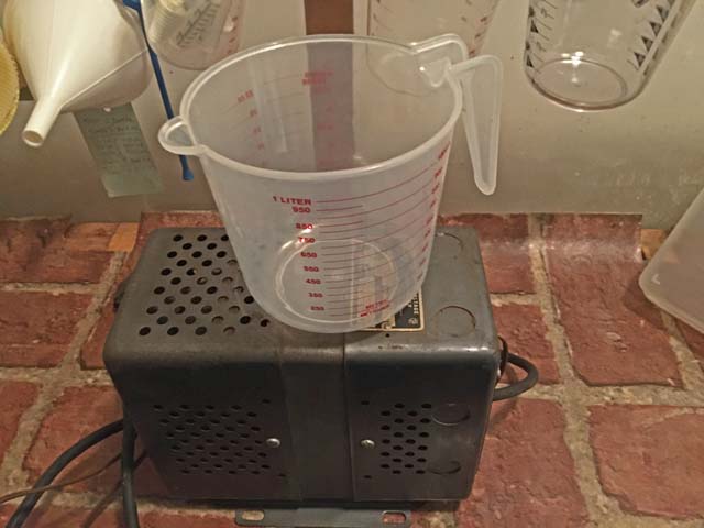

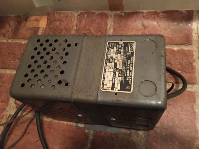

In the early days of small computers, it was not uncommon to have a "constant voltage transformer" (CVT). These used some magic tricks with ferroresonance to provide voltage regulation approaching just a few percent. In a quick look, it appears they still are made, but they are pricey.
Here's one by Tripp-Lite. I vaguely recall there were some that included a bit of waveform filtration because the most basic units sometimes put out a somewhat ratty waveform. To drive a lightbulb that likely wouldn't matter.
Another one-time maker was Sola, but that maker has rumbled through a bunch of various owners and I'm not sure they still offer CVTs. I happen to have one good for 150 VA that I think came from the dissolution of a start-up decades ago. I have used it but not in a long time. That sucker probably weighs 7-10 pounds, there is a lot of iron in them.
The unit
Nameplate
A sense of scale (1 liter measure)
