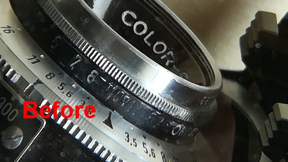

The distance scale white numbers of my Vito II are illegible. The engraved marks of those numbers are barely perceptible.
I see that in several Vito II advertised for sale, it seems a common problem.
Is there any way to "ressuscitate" the white colour of the numbers??
The small size of the numbers and the position of the scale ring does not make that an easy task.
Any sugestions and advice are welcome

The numbers are not obscured, the paint has really vanished.
In other cameras I used to borrow my grandchildren wax marker (white), sharpen it, soften it ner a flame and "paint" the numbers. Any excess white wax is easily removed. Here the problem is the lack of space - the numbers are too small and the grooves are very shallow. I have some white thin acrylic paint, so I will try Dan Daniel's advice. I will need a loupe - and patience.

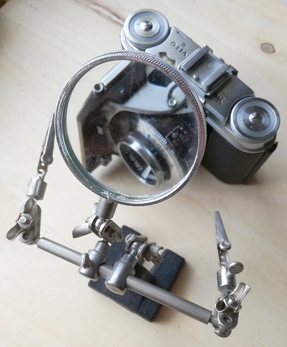

For work like that, I use the strongest off-the-shelf reading glasses I can find in my drugstore - easier than fumbling with a loupe. Fixing the camera in an ergonomic position on a table tripod also helps.

I use a loupe attached to a heavy base, it gives enough magnification, I hope. (attached photo)
I will post images of the result

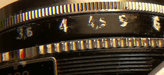

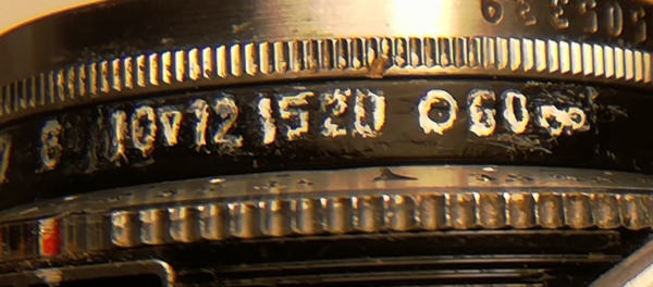

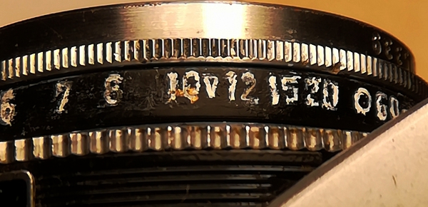

After some hours of struggling and despite my old eyes I managed to improve the visibility of the numbers in the distance scale ring. I used acrylic paint from a thick white acrylic marker and wood toothpicks sharpened according to the numbers being painted (or paint needing to be removed).
A well done job? Certainly not, the numbers look awful. But now I can use the camera, and that is what matters to me. I will try the camera next year
I attach some photos of the result. And thank you again for the sugestions.

Sirius Glass
Jan 18, 2007
50,389
Southern California
Hello
Have a nice 2023
Joao
You did better than I did. Another pass with the paint and it will look much better.
