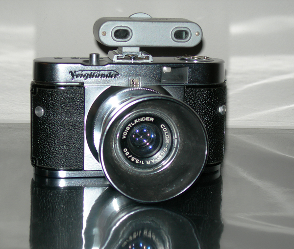

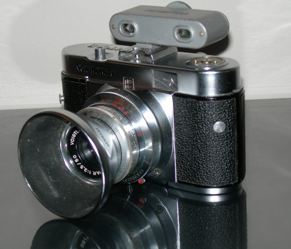

I just got a Voigtlander Vito B, unfortunately the seller neglected to mention that the shutter is frozen solid. Anyhoo, does anyone know of a good place to send it for a CLA? Also, I would like to find an instruction manual for it, a pdf would be fine. If you happen to know of a website with that manual, I would love to know of it.

I have a Vito B, look here to see pics:
http://www.pbase.com/dave85/voigt200
If it's the same as yours and you have any questions let me know.

Thanks for all the tips and links everyone! It's funny, even not working I have already become attached to this camera. It's VERY comfy to hold, etc. I hope to get a good CLA on it soon so it can be up and running. Dave--those pics of your Vito are super cool! Any chance you might want to scan the manual at some point? Anyway, I'll keep you all posted on the progress. I have one other interesting older camera on the way--a Zeiss Ikon Contaflex with 3 lenses. Ebay fun (hopefully working next time!)
