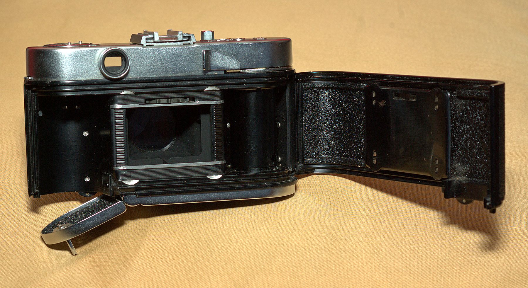

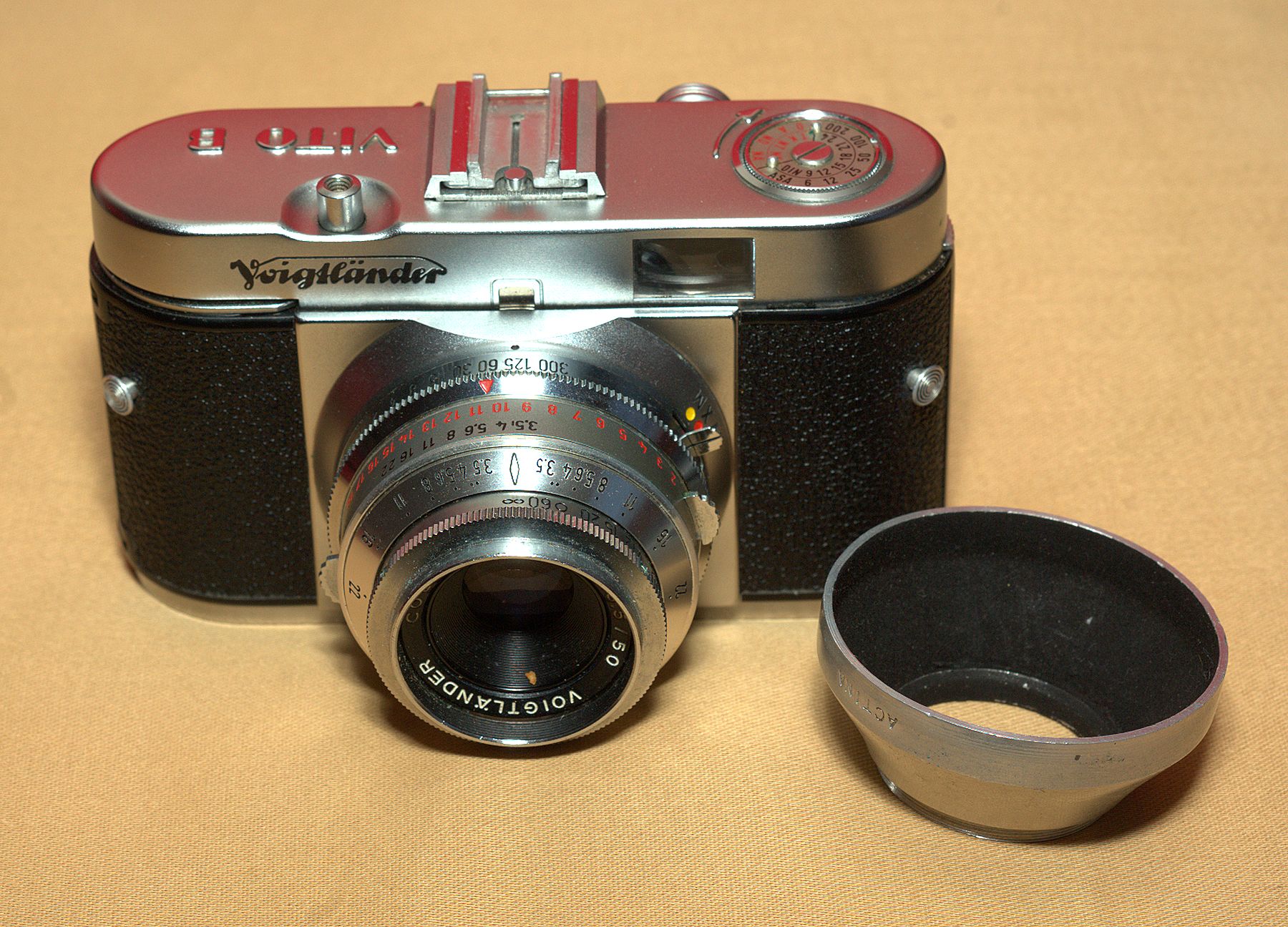

Just given by a camera Club member his 1950's classic German 'Voigtander Vito B' in good condition BUT when i loaded a 'test Film' to get the shutter working i found there is a fault -- I cannot release shutter with the button as when I complete the film wind action the shutter fires THEN !
I see there is one screw in the film cassette chamber at top and there is one other on the accessory shoe. is it worth a 'look' or shall I seek out a 'Classic Camera repairer' here in England at great Cost OR have any members of THIS Group got any advice ?

Can't help with the problem Pete. but I have a Vito B and love it, I have taken some terrific shots with it in fact it was the first classic 35mm camera I ever bought, for the grand sum of £29, about 15 years ago and still going strong, just a suggestion that it could be something to do with the film advance, to test this turn the wheel in the center top of tje frame, tis is turned by the film sprocket and is the wheel that sets the shutter, if you turn it untill the shutter sets and the film advance lever locks and the shutter does not fire then you know it is something to do with the film advance, hope this helps you find the problem

According to this instruction manual http://www.cameramanuals.org/voigtlander_pdf/voigtlander_vito_b_donate.pdf shows the camera equipped with either a Prontor or Prontor SVS shutter.
I have factory repair manuals for these shutters on my google drive if you want/need them, https://drive.google.com/drive/folders/0B1sPJkp-MdghNGM1aGY5akgtTmc?usp=sharing
Now with the shutter immediately releasing at the end of the cocking sequence either the shutter is not being fully cocked so that it latches or the release lever is not fully disengaged allowing release at the end of cocking. There are also levers internal of the shutter that may be sticking and not catching the mechanism as they should.
The service manuals show the Large Format versions of the shutters and camera body incorporated versions have some difference in the cocking and release levers.
Sit the camera in a warm location until the metal parts feel normal room temperature to the touch then operate the camera several times verifying that the wind action is at the end of stroke, the release button is fully extended, and the rewind is fully disengaged.
All parts will come off from the front of the camera if you decide to open it up and have a look.

I doubt that the problem is inside the shutter.
I have messed around inside a couple of these cameras. Without doing anything with the shutter, you can remove the complete lens/shutter assembly by unscrewing 4 screws which you will find under the front leather. After that, I may not be able to help you any further, except supplying a few pictures of my own mess with it. I found the winding/release mechanism difficult to understand.

YO !!! Grahamp !!! You are a 'Saviour' !!! That seemed to be the Problem -- I tried with a Cable release and pressed it then shutter fired , then I have wound on and NO shutter went prematurely until I pressed the release button gently as it should be . the 'Donor' said he had used it about 10 years ago and it was working OK --- now I will try it outside. I used a FLASH inside and that went OK --- keeping fingers crossed ----- YO !!

So a stuck lever was causing the problem and operating the cable socket release released it. Lucky you! You did not have to disassemble anything. The few Prontor and Compur shutters I've encountered that released immediately upon releasing the cocking lever required a full disassembly CLA to get them to work properly. Please let everyone know how the pictures turn out.

Well today I took a few Test Shots, Cut the Film and processed in well-used C41 -- The Shutter Fault seems to have returned ! Flash works OK though
