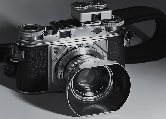

Ross Chambers
Apr 26, 2004
701
Blue Mountai
Love mine, and MF and LF are my usual weapons of choice. It's fashionable to decry the layout of the body, but for the left-eyed it's good (not sure about the right-eyed, mine is terrible thanks genetics!).
It built like the proverbial brick (out)house.
I have the Voigtlander VC II meter attached which matches the Prominent winder and focus nicely, but is obviously not essential. My problem was remembering that there is no linkage between the meter and the lens, ya gotta do it manually. The manual, somewhere online, will advise you to assist the cocking of the shutter at 1/500 with your hand.
There are a few lenses, but I'm happy with the 50mm Ultron.
Regards - Ross
