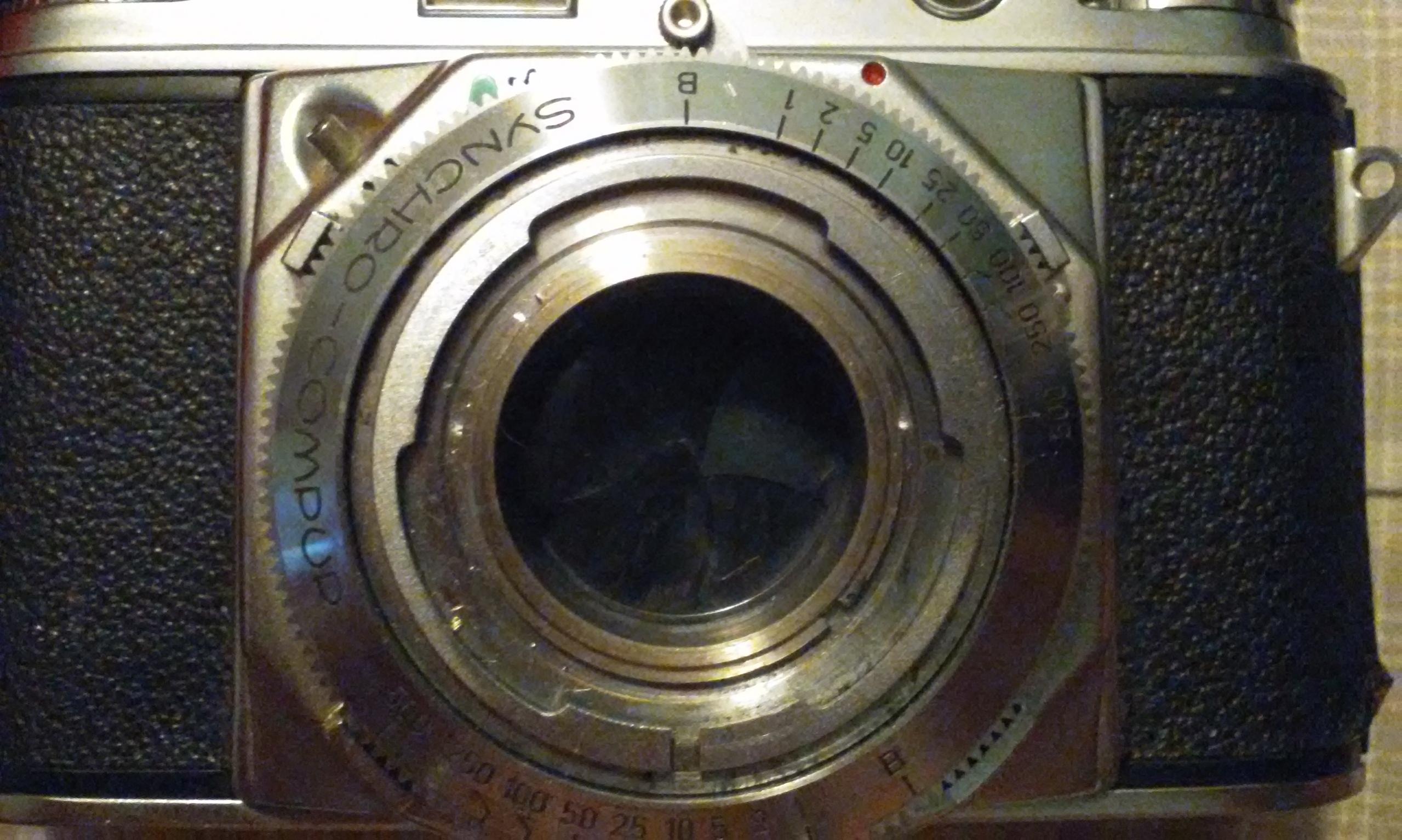

The shutter on one of my Prominents needs some serious shutter help, but I can't figure out how to get into/open the shutter. The only screws I see are inside the back, which I would guess would remove the whole lens mount assembly. I just want access to the shutter innards. Anyone know how?
attachment.php
The only thing I can see is a retaining ring type brass ring near the opening, but I couldn't get it to budge with decent force using a proper spanner wrench.

I'm surprised that the retaining ring you mentioned won't come off Kirk. From all appearances, you should be able to put a spanner into those notches in that ring you mentioned and spin it off. Whether that gives you access to inside the shutter or not I couldn't say. I've been inside a lot of those types of shutters before and never had any problems opening them up, so maybe it's just frozen and needs a few drops of penetrating oil on the edges to set for a day or two before it comes off. Did you try heating it up w/ a hair dryer? Probably 80% of the time, my cameras like yours w/ those types of shutters were fixed by giving the shutter a good douse of lighter fluid and/or high test alcohol (not the usual watered down stuff, but the stuff w/ a high alcohol content around 91% that Publix sells) at the part where the shutter speed selector ring meets the rest of the shutter surrouind, and letting it soak into the shutter internals. It's probably dried lube in there. If something is actually broken, of course that wouldn't help.
From my years as a machinist, I know that a few good taps w/ a small hammer onto a screwdriver pushed into those cut outs, along w/ the penetrating oil setting for a few days, will usually get something unfrozen. Even those Agfa Isolette shutters w/ the green gunk that freezes up the focus came free once I soaked them in that alcohol for several days. My last one was so stuck, it seemed welded into the helical threads, but after 3 days of soaking in the alcohol it unscrewed w/ just my fingers.
What is wrong with the shutter?

I applied some liquid wrench to the retaining ring, and so far, still no luck getting it to budge. The thought of using a hammer isn't a pleasant one, but it may come down to that. I'm just worried about the soft brass (unless its bronze) getting damaged.

So I finally got the shutter open. If I had to guess, I think someone was in there before, and mucked up something. It still seems to just be something that isn't catching, but for the life of me, I can't figure it out.
Maybe over the weekend when I have more time I'll dig deeper, but that'll be a project. I do have another Prominent that has no issues, and I'm inclined to open that one up to see if I can find a difference.
