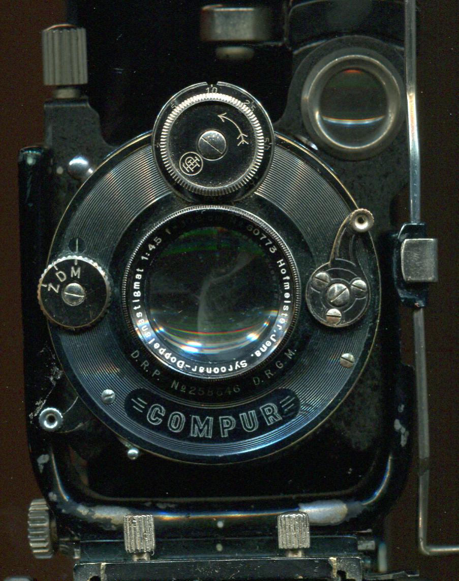

I'll try to get some photos later. It's a 6.5 x 9cm with a 10.5cm Syrconar-Doppelanastigmat 1:4.5 Hofmeister, Jena in a Compur shutter. The only marking on the outside is a small round logo that reads "Walter Talbot Berlin"--thought the top part of it is missing, I think it says Walter.

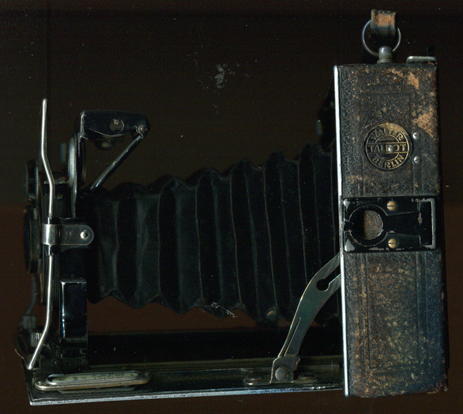

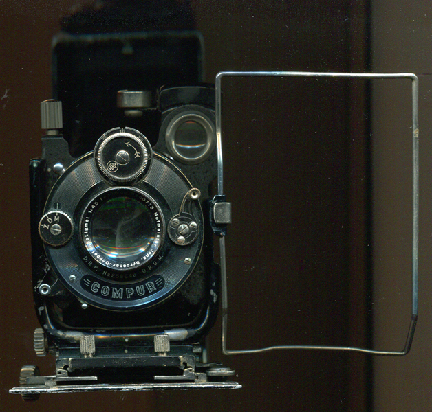

A few "pics"---I just put the thing on a scanner. That's the best I can do right now!

Lens Vade Mecum says these lenses were used on Norica Minor and Trumpf Cameras by Conrad A Muller- but you are sure it's a Voigtlander camera? It generally has good things to say about these lens although no mention of the "Doppel-Anastigmat" in particular. It's probably a Dagor design lens.

Maybe a "Walter Talbot" mfg. in Berlin, patterned after a Voigtlander?
