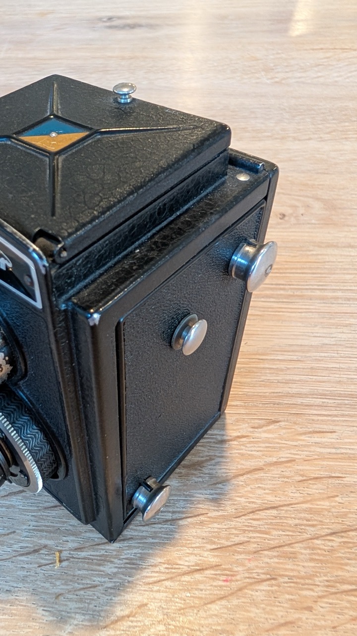

Hi, I have the earlier all-metal Voigtlander Brillant TLR with Skopar 75/4.5 lens. I really enjoy using it due to its diminutive size while offering good quality results, however I have trouble finding the correct accessories for it.
1) Straps: it has two rounded knob type of strap lugs (see attached photo), but I cannot find a strap connector that fits. It's different from the Rolleiflex, and different from Mamiya/Hasselblad types. What type should I look for?
2) Hood and filter: there are conflicting info online about 29mm vs 30.5mm. I measured with caliper, and it seems to be 28.5mm inner threads and 30.5mm outer rim size for push-on. Do you have any success in finding the hood and filters?
Thanks!

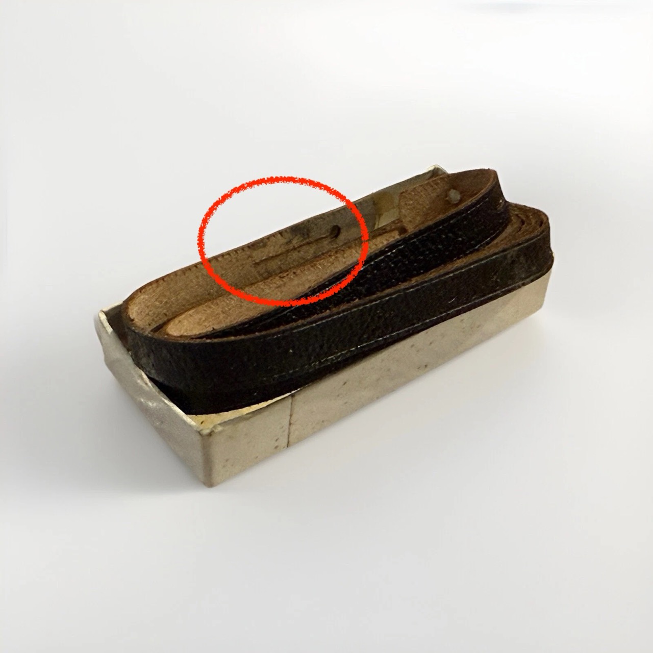

I solved the strap problem by looking at some photos off ebay (as below). Basically you just need a leather strap (I have a few blanks at hand), a hole puncher and one sharp Xacto knife.
