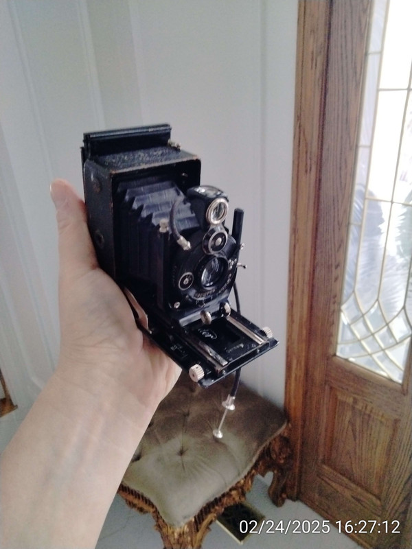

I purchased recently a Voigtlander Avus in the 4.5x6cm format. The camera appears to be fully functional despite its age (according to the serial number it was made in 1926).
But I have a problem. It didn't cone with any film holders. I see a few on ebay but not in the correct size - all the ones I see for sale are either 6x9 or 9x12 (and some 10x17cm also).
Does anyone know of a source for those? Or have an idea of the size and construction thereof? Modern reproductions? Or maybe even better 3d print models (I have a 3d printer)?

Hmmm. It might be a Bergheil. Very similar device.
I'm trying to attach a picture but it won't let me. It says file is too big even though the jpg is 450kB, and I see the file limit is 2MB.

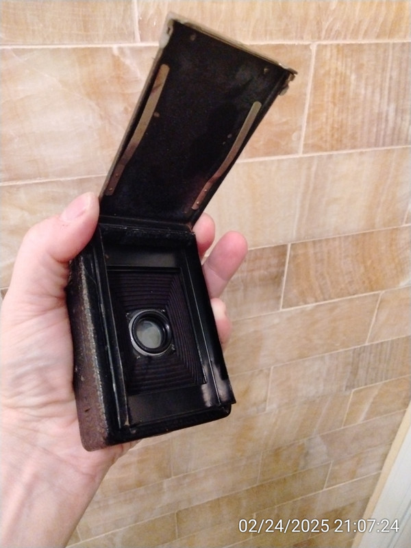

This is the back I have on the camera. A cassette that slides up, and also opens upwards on a hinge to place the plate inside.
I plan on making custom daguerrotype plates to place in that cassette. But if I had film holders it would be easier to change them from one picture to the next outside of a darkroom.
Hmm. I may need to get into sheet metal fabrication. :smile:

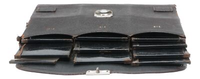

It does appear that you may need to make your own. If it helps, this is what they look like:

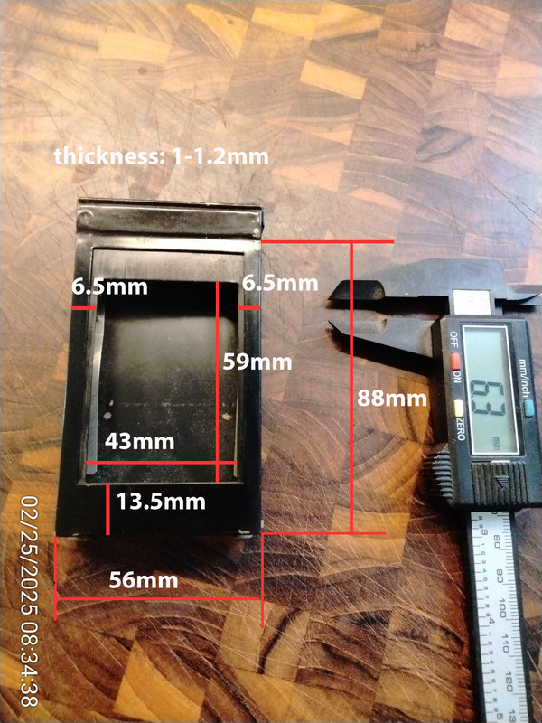

Okay I measured the dimensions of the backplate and of the opening therein. :smile:
Posting this here, maybe it will help someone else in the future.
Basically, the part that slides in the camera is 1-1.2mm thick (thickness is not uniform, varies with where I measure it)
Outside dimensions: 56mm wide, 88mm tall
Opening: 43mm by 59mm, located 13.5mm above the lower edge and 6.5mm from the lateral edges.

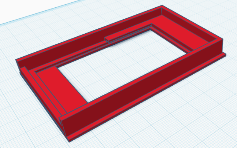

And an incredibly simplistic 3D model I made based on the above, in zipped .stl format

And another 3D model for a mode complete backplate including slit for a custom metal slider and holder for cut film or plates of 4.5x6cm, up to 1mm thickness; as well as a separate back cover. It may contain errors although I don't think so. I can only 3D print fused-filament not resin and this model is not appropriate for that, so I ordered a few copies of each resin-printed online. I should have them in the next 1-2 weeks for testing.

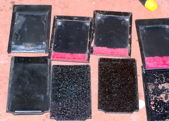

I have a Goerrz Tenax that takes 4.5 x 6 cm glass plates. Have some plate holders and can send you a picture. They look like stainless steel and each one takes two plates, that must be rather thin. I don't think they were ever used. It was used mostly with film from a film pack holder, which I also have (along with a lot of the negatives).
