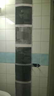

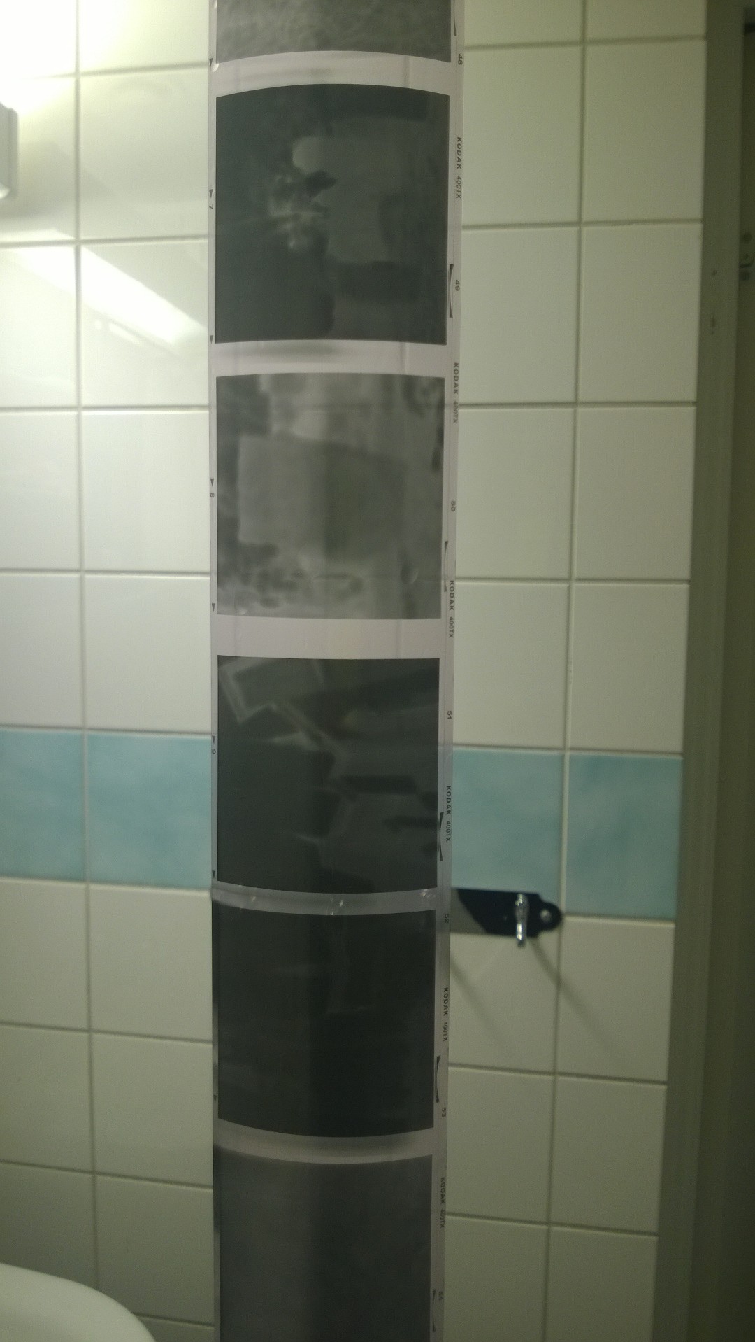

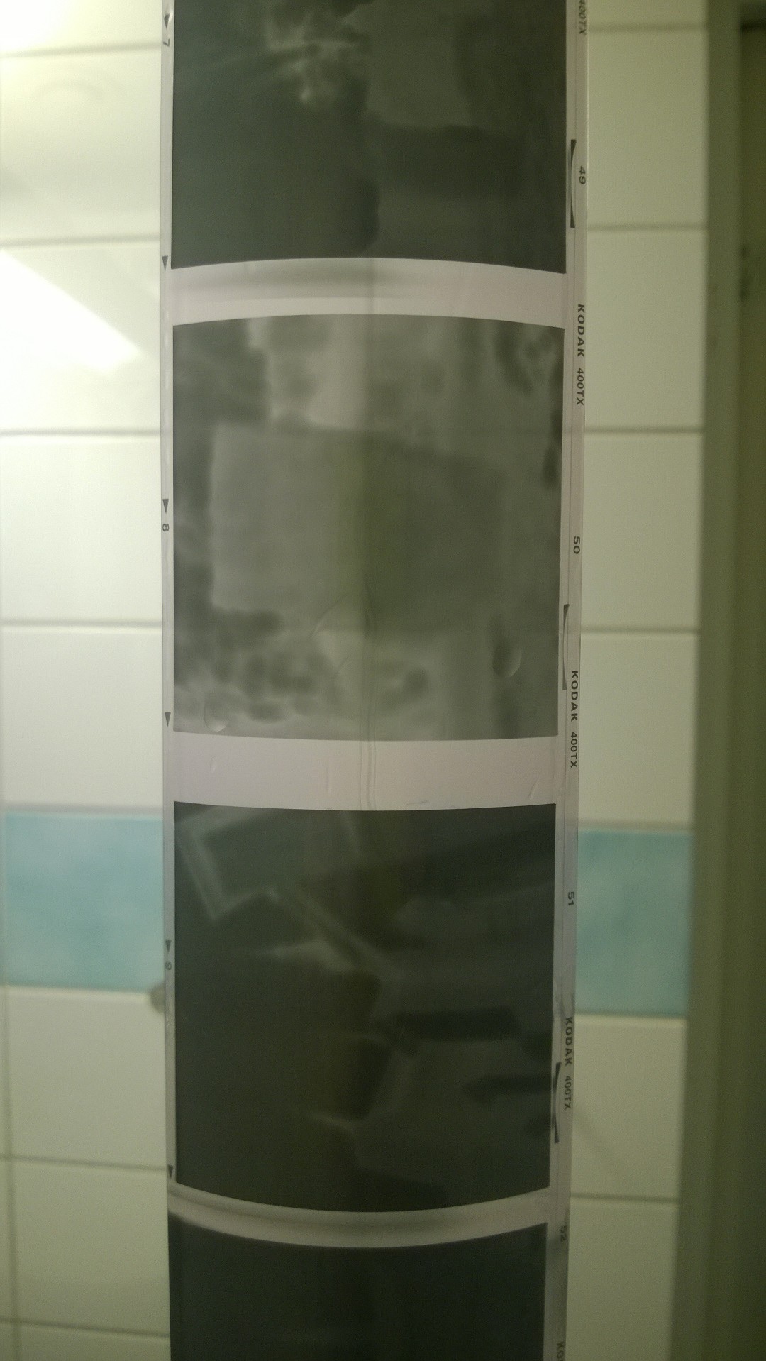

I'm devastated right now, my new Superb seems to be a very expensive paper weight.
I developed my first test roll and realized something was very wrong. There was absolutely no sharpness in any of the pics, not even the ones at infinity F8-F11, and blur looked really weird.
attachment.php
attachment.php
After checking with tape I noticed that the focusing was extremely off, a lamp close to me was getting closer to focus at infinity but still a blur.

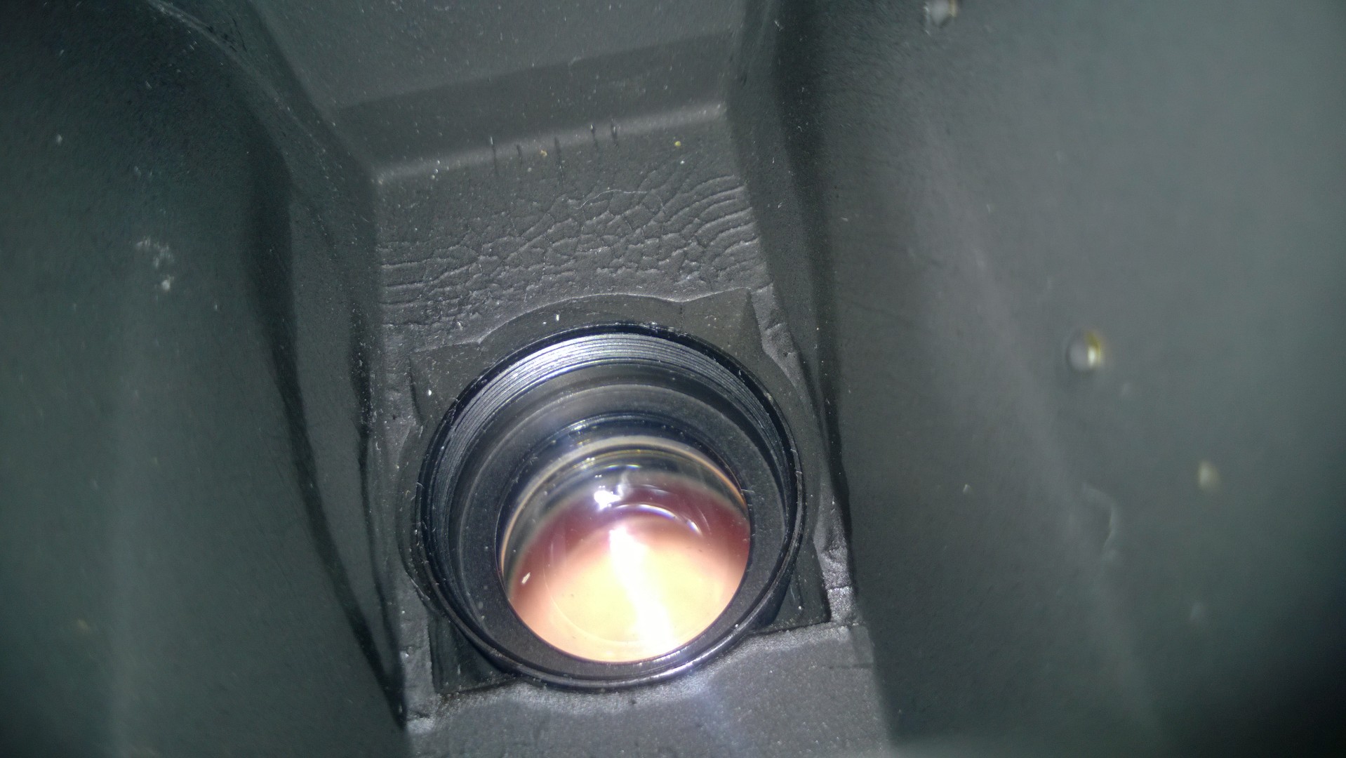

Then I inspected the lens closer and realized that the Heliar seems to lack the rear group. Anybody who can confirm?

Yep, that does not look right. Just to be sure, turn it over and shine a flash light into the lens and look for the reflections of the light. There should be 5. I'm betting you only see 3. That's really too bad, as the Heliars on all the Voigtlanders are superb (sorry!). Hopefully you can send it back for a full refund. You could hunt up a rear element for it, but they are not exactly common.
Dec 1, 2014
80
Sweden
I see six reflections, three on either side when from an angle. That sounds about right with six air to glass surfaces. The Heliar was what sold it to me, they are indeed superb! Half a Heliar? Not so much.
Yeah, I contacted the seller and we'll see how this goes, an anti-climax after craving a Superb for so long. Hunting down a rear section for the Heliar would most likely mean another camera for the same price, it just don't make sense. If there was a broken one with a Heliar on Ebay or similar then maybe but I haven't seen one.

VD, you seem to have a focusing problem, not a lens problem. I have a heliar type 105/3.7 Ektar ready to hand and asked it whether its rear group (a cemented doublet) or its front cell (center group, a singlet, and front group, a cemented doublet) could form an image. No. Your lens forms an image.
Check that the focusing screen is in the right place and oriented correctly (ground side facing the mirror) and that focus in the film plane coincides with focus on the ground glass. It is possible that the taking and viewing lenses are out of synchronization or that one of them has been replaced. Remember, they have to be a matched pair and having the same focal length engraved doesn't guarantee a match.

You may be right, I got no real idea but another guy told me that one group is missing in the last lens threads. Anybody who got a Superb with a Heliar?
I shot test shots also at a small aperture around infinity just to take the screen out of the equation and that is just as blurry. I also also shot at 0.8m with both foreground and background but that's just complete blur too. Only really a really bad synchronization or a lens fault left as a possibility left as a possibility. As each frame of the film got razor sharp edges I doubt it's a processing or film advance thing.

I unscrewed the front group that one splits in two groups. After that comes the aperture and behind it the one or two last lenses (can't see). As the infinity setting seems to be closer than the supposed to be minimum focus I can't see how it's an error with the helicoid, the lens seems like the main question mark in my eyes.

You're right, 5 elements, but 6 air spaces. My mistake. Still, looking at that photo that you posted of the lens, it sure looks like there's the rear group missing. But maybe not. Strangely, I actually have a Voigtlander TLR w/ a Heliar lens coming tomorrow or the next day in the post, but my camera is a Brillant, and the lens design is surely different than yours.
Dan Fromm
Mar 23, 2005
6,835
Five elements in three groups. Two air spaces. Six air-glass interfaces (is that what you were thinking of?) so six bright reflections, of which four from one cell and two from the other. Two glass-cement-glass interfaces so two dim reflections, one from each of the outer groups.

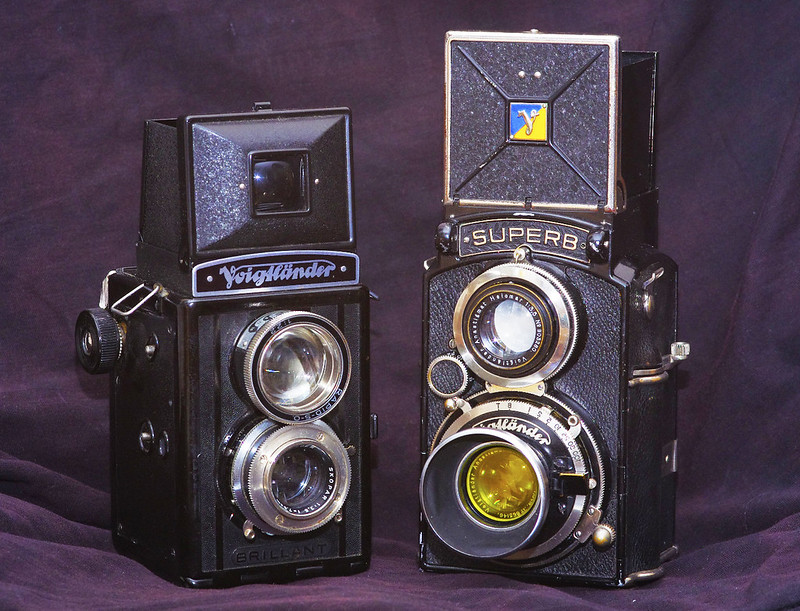

I got the Superb back from the CLA and it now got "downgraded" with a hopefully working Skopar now instead, the joy! :D
I now got one and a half Superb as the spare body basically only needs a working lens now. I got the Heliar in pieces with but I can't seed what's wrong a all, the poor fella must have been butchered badly a mix of elements.
Voigtländer Superb Brillant by Andreas Sundell, on Flickr
