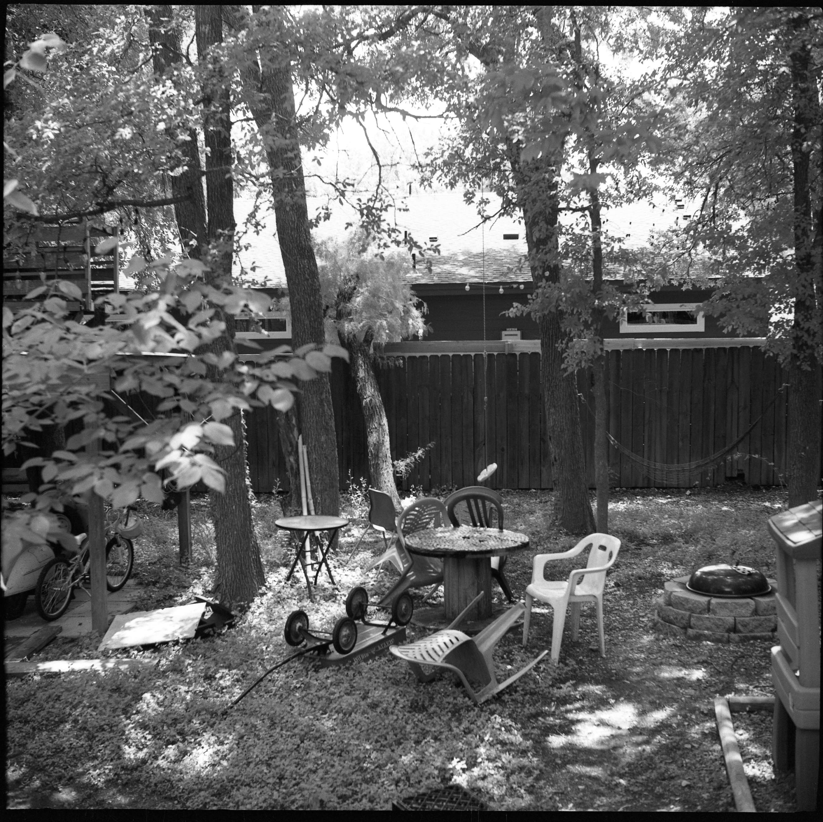

So I've gotten my first folder, refurbished by certo6. It is a damn nice looking camera I must say. I tried some test shots with my watameter, which I calibrated at infinity. The test was a sunny day, I think I had it stopped down to f8. Does it look like the focus isn't quite right in the center or my focus also seems to be off a bit? Again, I'm coming over from using vintage slrs, so something like a folder is entirely new to me (and I'm just a hobbyist).
In the first photo I think I focused on the tricycle seat and In the second photo, I had the watameter lined up dead on with the tires on that tire planter. I'm using superpan 200 developed with tmax liquid. Thanks for any input.

The focus is definitely off.
It is hard to tell in the bicycle picture. But the handle furthest away is in better focus.
It is easier to tell in the tire picture. Look closely at the grass the grass behind the tire. You can clearly see a plane where i it is in better focus.
What Dan Fromm said was correct. The distance settings on the camera are set from the lens to the subject, not the film plane to the subject. But the focus error in those images are much greater than that
You need to check your watameter for close focussing as well as infinity. And you also need to verify the settings on the camera.

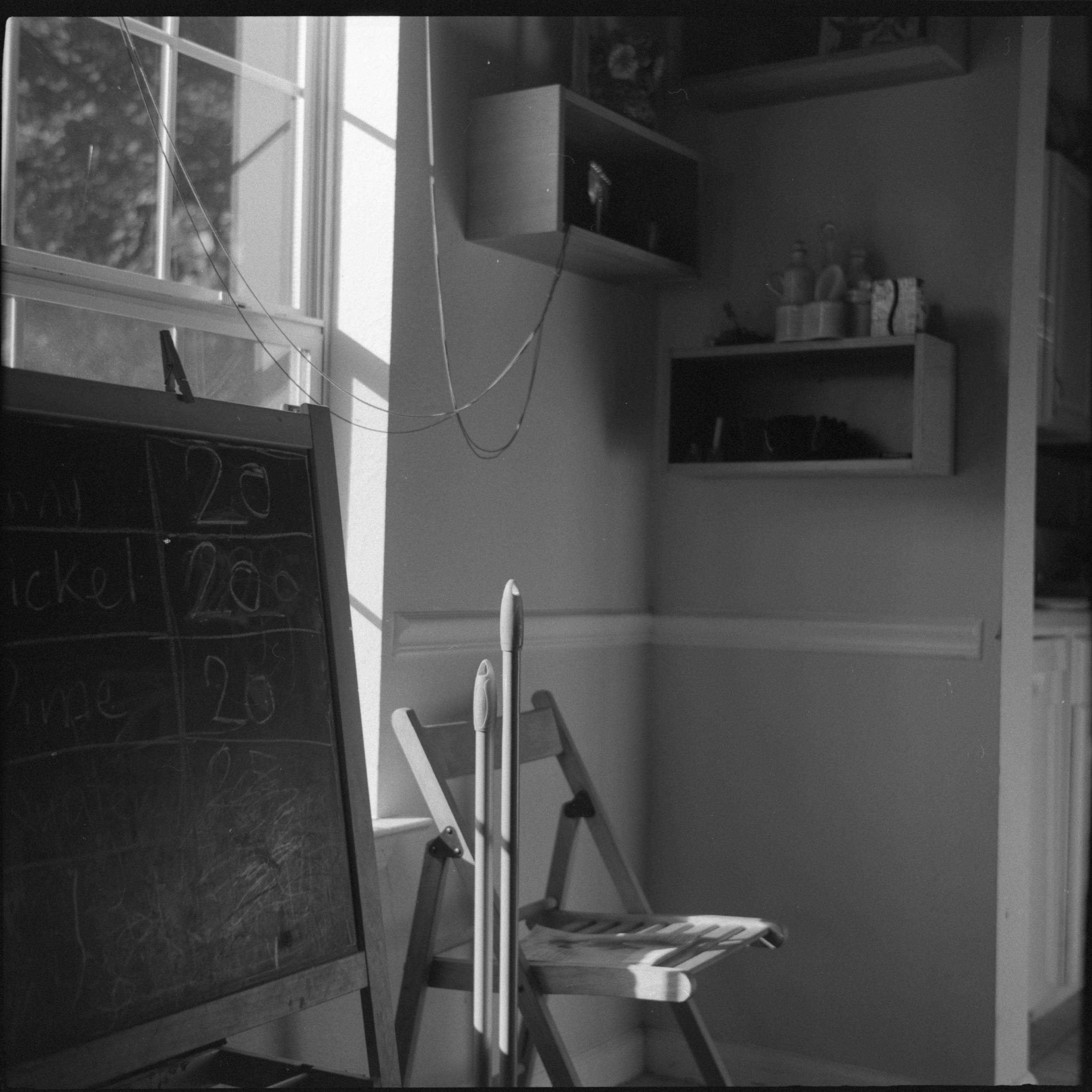

I guess I'll break out the tape measure and tripod. Again two more. On the first I read the watameter for the child's slide and it seems to be focused behind it and the second I read the range for the table and chairs in the center. I was more concerned that I was getting soft focus in the middle and not the sides, but it looks more like just the focus is off.

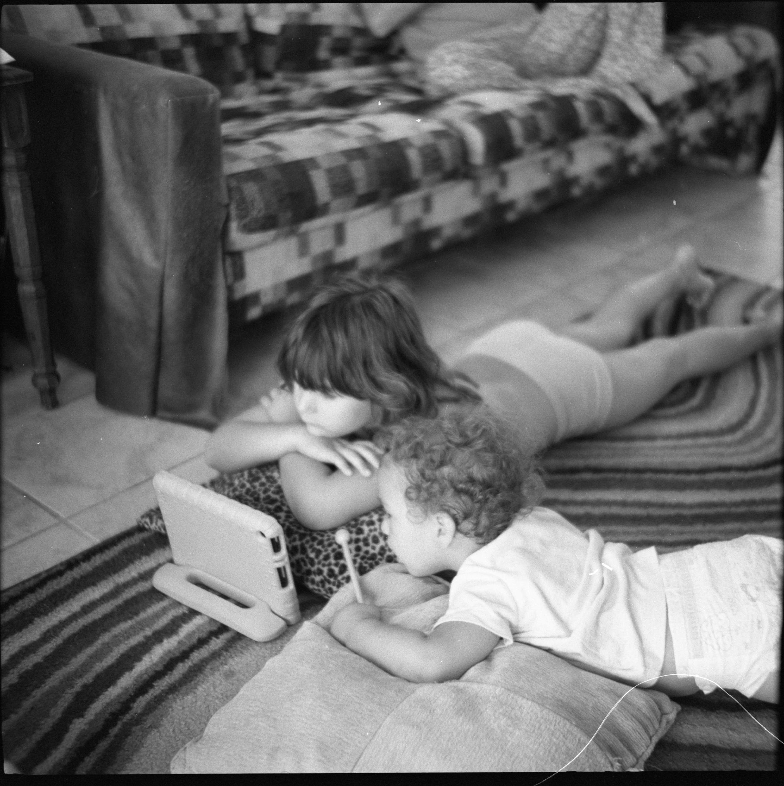

Ok this time I used measuring tape.
1st picture 5.6 measuring tape from inner edge of chalkboard
2nd f8 watameter on tricycle seat. No measuring tape
3rd f5.6 measuring tape to the little boy's head. His head looks pretty soft to me (focuswise, not his real noggin)
4th is the seat again with watameter to seat. No measuring tape. I didn't double check with both the watameter and measuring tape outside. I'm not sure why I didn't do that...
