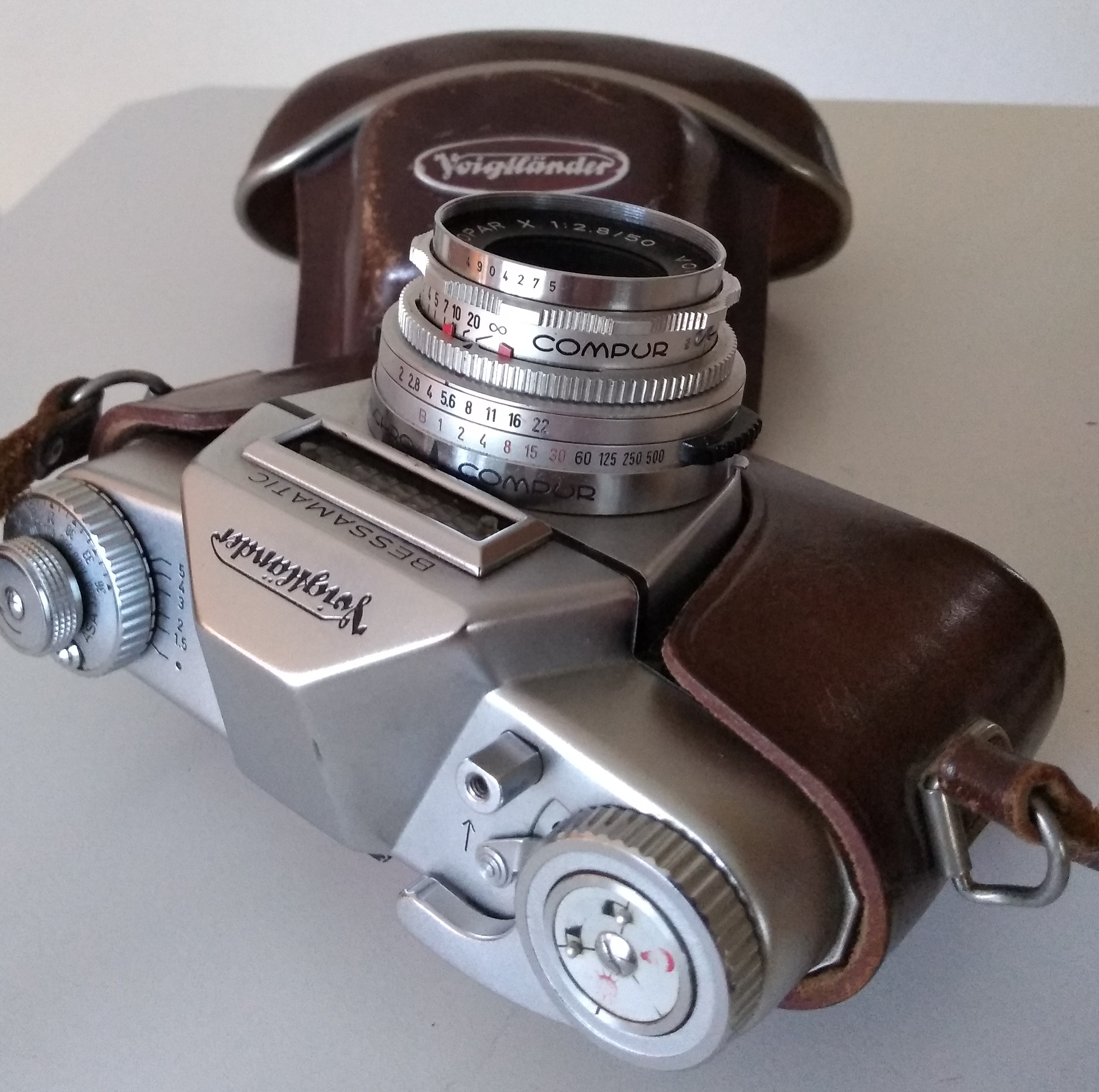

Ten or so years ago I bought a nice Voigtländer Bessamatic and made many fine photos with it. Alas, the behind-the-lens leaf shutter became jammed some years ago (shutter is cocked but won't release). I've been told that repairmen don't want to fix them because it's such a difficult job.
However, I would be willing to pay enough to make it worth someone's time and effort.
Is there anyone who does this?
Being unskilled and unknowledgeable about camera repair, is there anything relatively simple I could try?

I had this with my Bessamatic and the flushing with naphtha worked fine. That was a couple of years ago and no further problems.

Right. Flood it w/ lighter fluid, and give it a couple of good knocks on the table top. That will usually work wonders, but if it doesn't, perhaps it would be cheaper and better to buy a fully working one w/ a guarantee and sell yours.

UPDATE, 2014.12.23:
The lighter fluid approach did not work - however, I did find an experienced camera repairman who knows these cameras and is willing to work on it.
I will provide details later.
Thanks, everyone, for your help.

That is appallingly bad advice in relation to a Bessamatic. Clearance between a rack and the bottom plate is quite tight. The cover is easily bent which will simply stop the mechanism in its tracks if the rack gets jammed, which it usually does. I was going to suggest removing this bottom cover to the OP as a possible fix (if the whole mechanism is locked, not just the shutter, they can wind even if the shutter is sticking). Having belted it on a table a few times (if they took your advice) that bottom cover is now probably fucked.

The bottom cover is fine; I didn't whack it :smile:
I guess wear, lack of lubrication, parts being out of time, or some combination thereof is the cause. Regardless, I'm confident it will be repaired properly. I'll be getting it back in January.

Theo, this is an old thread. Did the Bessamatic repair work out? Are you using the camera?
Somehow just saw this now.
Yes - my Bessamatic was expertly repaired and returned to me within 10 days at a very modest price. The guy who did it told me the Bessamatic was actually the first series of cameras he was given to work on when he first started camera repair long ago.
After receiving the camera back and testing it, I asked the repairman if I could give him public credit here and he declined because he already has plenty of work to do and, getting old, he wants to reduce his workload. However, he is known to some people on this site.
The camera works perfectly - even the self timer.
I have used the camera numerous times since then and it's been fine; exposures were good.
It will be a sad day when our best repair people of older cameras are gone.
