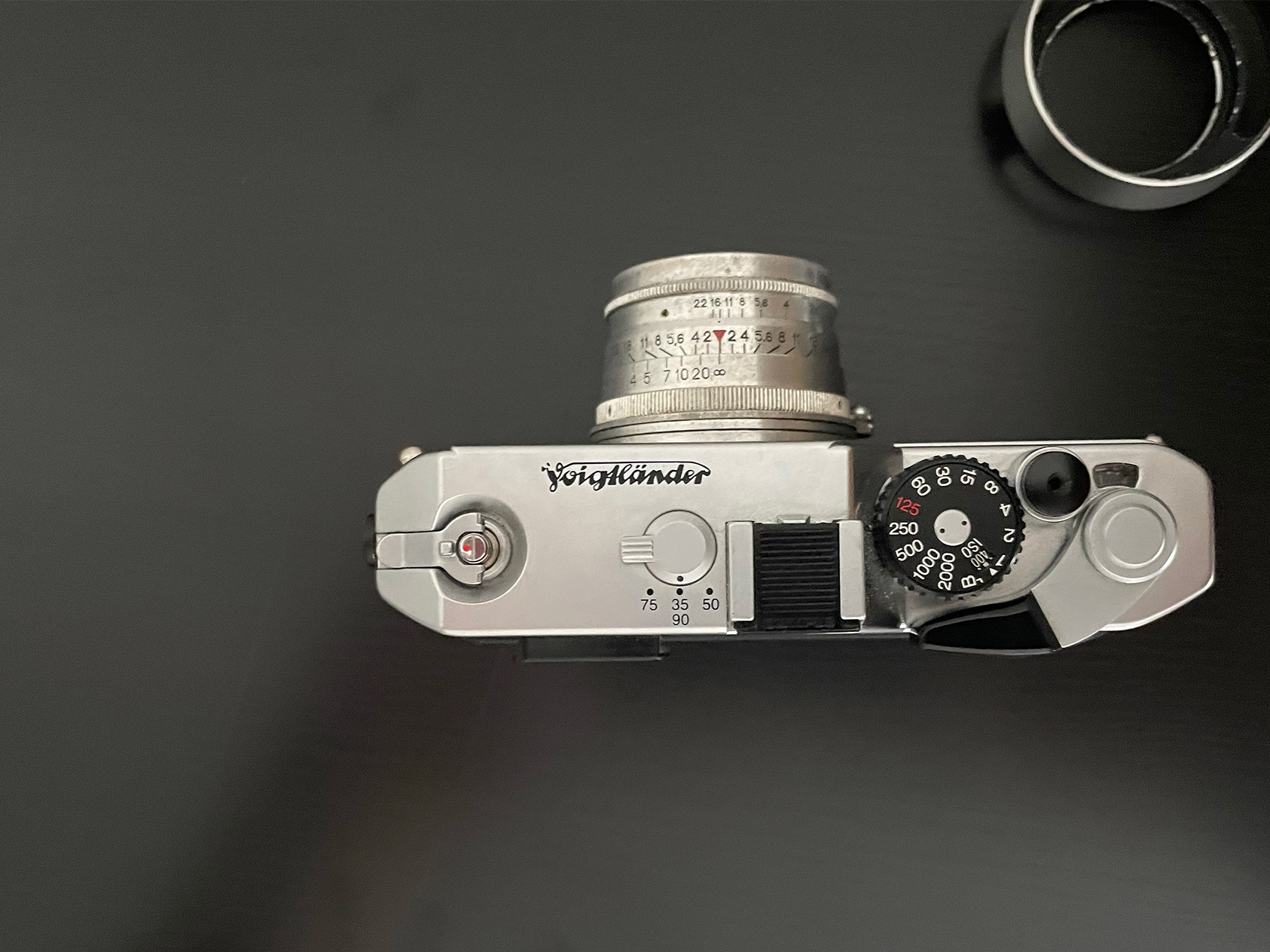

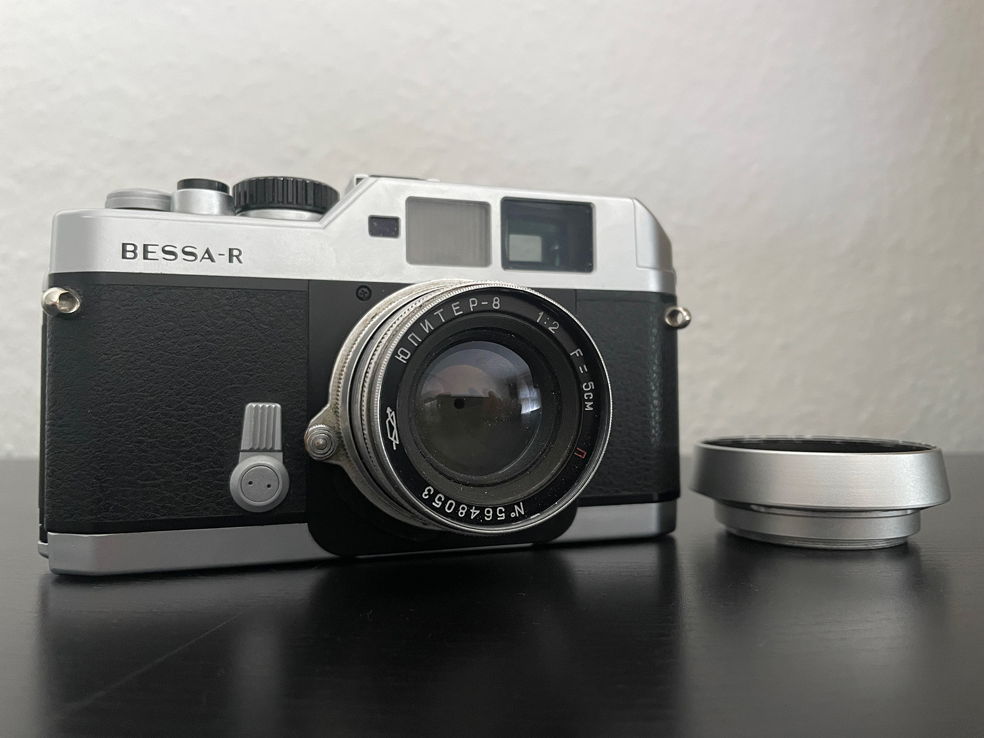

My Voigtländer Bessa R just came in the mail and im super happy about it, its my first rangefinder, I got lucky and bought the whole kit for 200€/237$. I had to sell my Minolta x500 for it but well... The focus ring is a little bit stiff ill see what I can do about that. Mechanics and meter work. I did some research about the Jupiter-8 lens it it looks really good. Can you guys recommend me other cheap LTM lenses?
