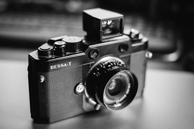

I just saw a Voigtländer 101st Heliar Anniversary Set (Bessa T, LTM to M adapter, collapsible Heliar 50mm f/3.5 with hood, 50mm viewfinder and Trigger Winder), original boxed in mint condition for a bargain price.
I am tempted to buy this set … :unsure:
I am used to Rangefinder cameras (Konica III, Konica Auto S2, Olympus XA, FUJI GW670, FUJI GS645S and some more) but the Bessa T seems to be something special. I really like the idea of the 1.5x rangefinder built into the body, combined with a seperate 1:1 (50mm) brightline finder.
Does anybody here on APUG wants to share experiences with the Bessa T and / or the collapsible Heliar lens ?
Any recommendations for a wide angel lens (LTM) ??

I've been tempted by that lens more than once. It is, apparently, the sharpest lens Popular Photography ever tested; more importantly, the rendering seems quite pleasant and Heliar-like. I do have the finder that came with that set, which is very good (1:1 view, so you can keep both eyes open) but has very short eye relief, so if you wear glasses it won't work well at all.
No experience with the Bessa bodies, but if you don't like it you can always get something else and screw the lens to it.
How wide a lens are looking for to complement the 50? I've got a Snapshot Skopar 25/4 I'm looking to sell.... :wink:

I have a Bessa T, but not the Heliar :sad:
Build and handling is very much like the Bessa L - it's not a luxury camera by any means but it's stiff and light-tight, and easy to hang on to even without the accessory grip. There's a lot of plastic in the body (I think both top and bottom plates, as well as the film door, are polycarbonate) but everything is rigid and the body still has a pleasant heft. The rangefinder window is small but still usable even when wearing spectacles, and the meter indicator LEDs are readily visible with the camera to one's eye. I've found the meter to be accurate enough for my needs but I've only shot negative film in my T. Wind-on isn't the smoothest but it's still not objectionable, and the shutter release is smooth. The shutter itself makes a harsh clack when fired but is reasonably quiet.
For the £90 I paid for mine, it's a pleasant and competent piece of kit - like a product-improved Leica IIIf. Not sure I'd pay the premium for a collectable version, but then again I've never had the pleasure of the 50mm f/3.5 Heliar...

I've got the 101st Anniversary Bessa T in olive green, and it's a great camera. I use it as second body with my M2 and usually have the CV 21/4 or 25/4 mounted with the CV 21/25 brightline finder. It's a bit smaller and a lot lighter than Leica M bodies, but still seems to be of good build quality. Meter is accurate and quick to use, RF window is clear and the 1.5 mag is nice for 50 and longer lenses. I've got no problem using external VF's, and the CV or Leica bright-line finders are better than most cameras' built-in finders.
No experience with the Heliar, but I've read good things about it. If you're looking for a good small 35, you can't go wrong with the CV 35/2.5 Color-Skopar. The body is actually M-mount, so take your pick of any M or LTM (w/adapter) lenses out there.

Yes, it's all about the lens ... It's a favourable occasion to get one !
I don't wear glasses - I think the seperate viewfinder will work for me.
I guess the 25/4 is really nice lens but I would like to go a little more wide. I'll keep an eye on the Voigtlander Color-Skopar 21mm f/4 ...

Small, sharp, and distortion-free. It's a fine little lens.
Feb 16, 2006
2,349
Merimbula NSW Australia
Don't use mine often enough but can say that it is a classy little lens, like all the later CV stuff. Really good build quality and a nice titanium finish, I don't know how much they are asking for it but if you want a compact fifty for a LTM camera, then this is about as good as they get. Of course the slow 3.5 aperture may put many off, but as a substitute for the Elmar on a Cosina body or as I do, on a Leica 111C.
The Bessa T works really well too, quite plastiky of course, but does all it needs to do, and the meter works really well.

When the CV 101st Anniversary set was still being sold new, I bought one.
The Heliar was fantastic.
I didn't have the time to get used to the -T. I only used it a few times.
I sold it when I needed cash.
Now, I am older and regret having sold it.

Thank you, Tony !
The whole set described above is about 650 US-Dollar.
I would like to ask one more question ...
Can anyone describe the view through the Bessa T's rangefinder ? Is it comperable with the view through a longer tele lens ?

Always wanted that nickel 50mm 3.5 heliar to try. Prices for it stay so high, maybe because you don't see user versions of it often.

Just FYI there are two boxed sets on eBay with BIN prices under $600...

I have the 21/4 as well, but I'm keeping it (really only selling the 25 because it's too close to the 21). Both are quite good; I will miss the click-stops on the focusing ring of the 25 (very handy for street photography), but the 21 is RF-coupled and focuses down to 0.5m, which is nice.
