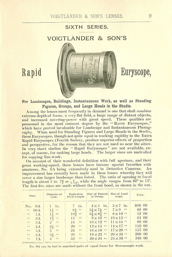

The measurements seem to fit a Rapid Euryscope Serie VI no. 5A; which would be a 24" f:7.75. Coverage was (in 1890, yours is older) rated to 17x20" at smaller stops, 16x18" wide open. It seems as if the "A" in the number was not engraved on the lenses, not was any of the other information. Just "Voigtländer & Sohn, Wien und Braunschweig", the serial number, and the number in the series.
So everything fits well enough that I would say we've found it!
BTW, I still believe it's an Aplanat (AKA "Rapid Rectilinear"). Even if my 1890 catalogue doesn't say so. It's just the simplest explanation that fits the description.
I search all over the net and my bookshelf for something, and eventually find it on my own harddisk:
Ole, thank you for your assistance. I truly appreciate you sharing your wealth of knowledge and research sources. Another mystery solved by a fellow apugger :smile:....Love this site!
In looking closer at my "5" Voightlander lens and my "4" lens, neither have an "A" designation by their number, but the "4" has inscripted on the barrel "Euryscope." My "4. Euryscope" has ssn 30922 so it would seem that it is "newer" than my "5" Euryscope which is ssn 25028. Both of these barrel lens have the same Voightlander maker inscriptions. My "5" Voightlander just does not have the "Euryscope" or the "A" designation.
A closer examination of my "4" Euryscope lens...shows that it appears to have the same lens confirguation as my "5" Voightlander.
