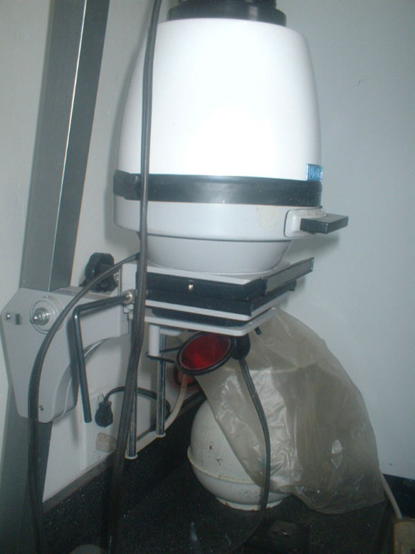

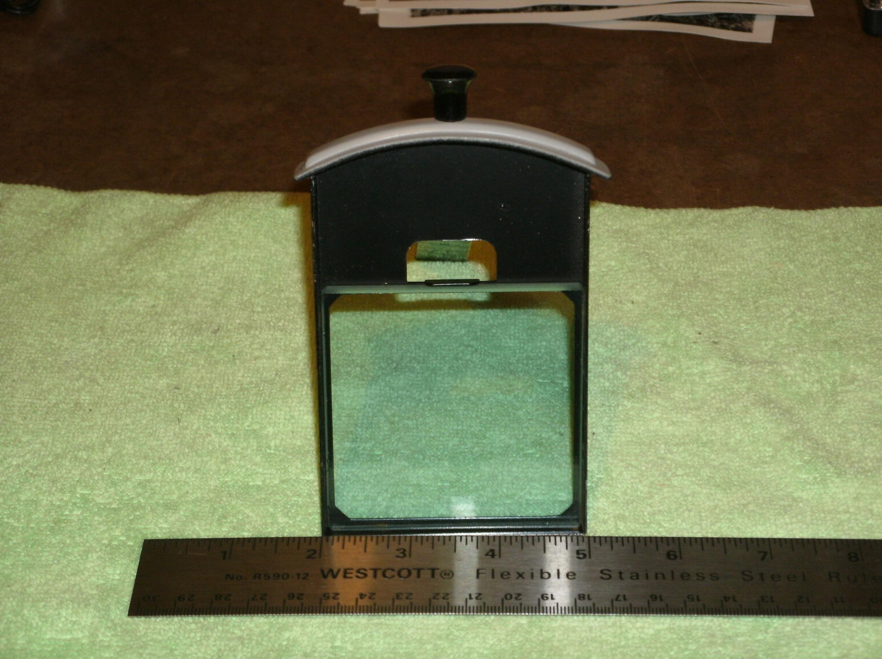

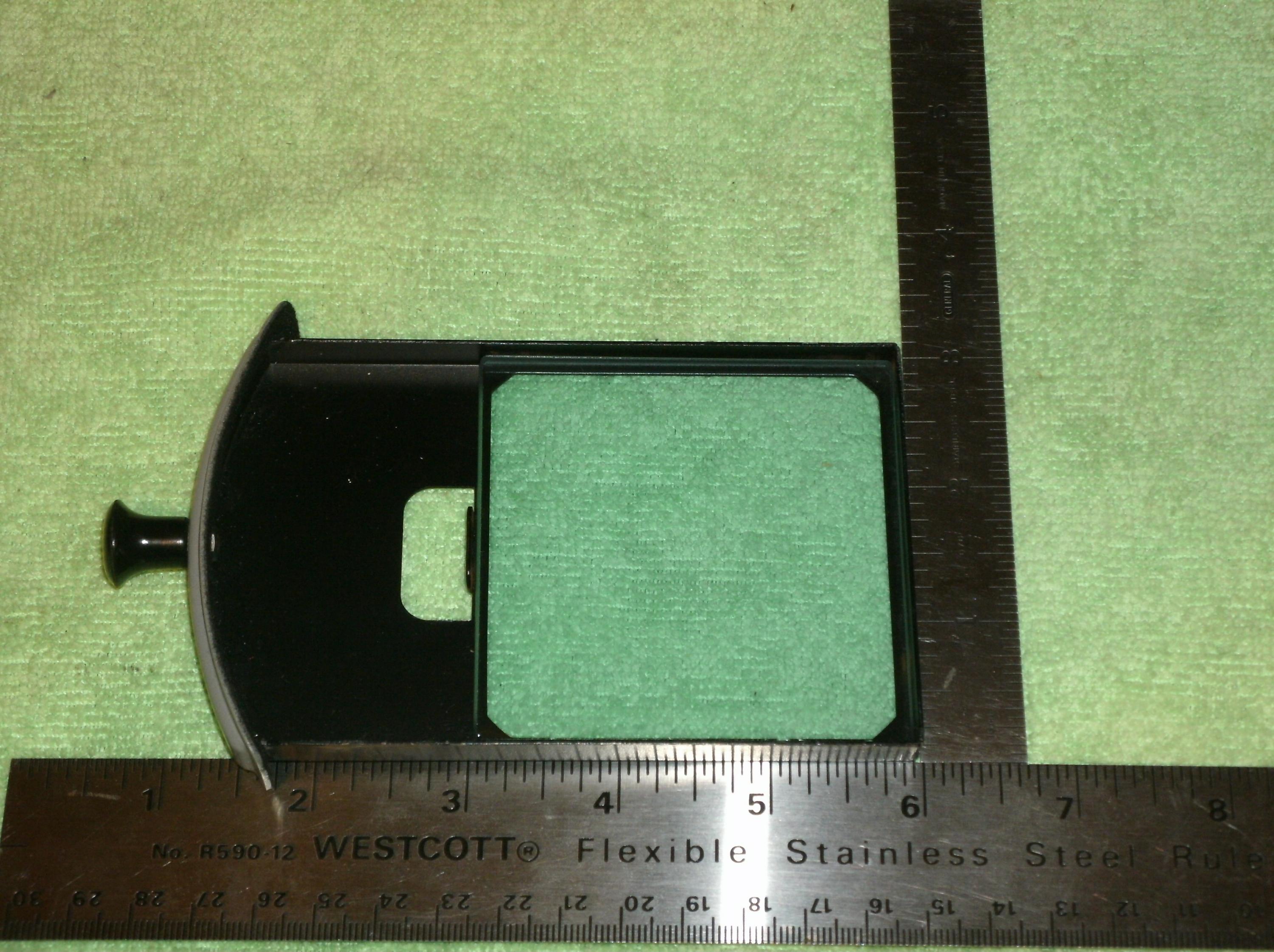

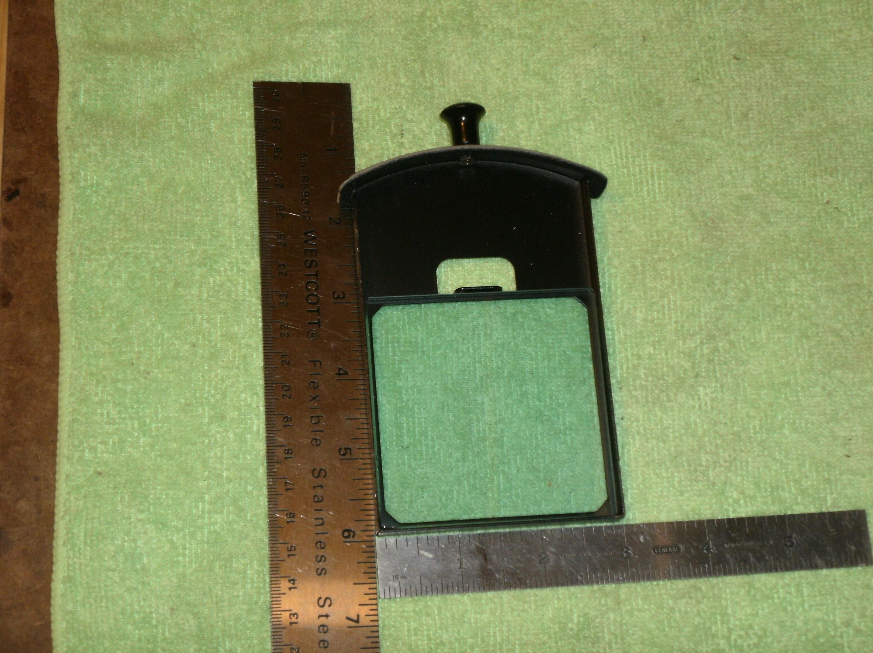

I have 2 enlargers that I got at a thrift store. One is a Beseler 67C in perfect working order, and the other is a Vivitar E-34. The vivitar is missing it's filter drawer. I know I could just tape up the hole that the drawer goes into and use graded paper, but I would like to be able to use it with VC paper. I was thinking about fabricating a new filter drawer to go into it, but I've been unable to find a manual that shows the original drawer.
Do any of you fine folks happen to have this enlarger? If so, could you be convinced to post a couple of photos of the filter drawer from different angles so that I can see what it looks like? I would like to use it, but if I can't figure out how to put filters in it, I will probably just give it away.
Somebody may ask why I want to use the vivitar when I have a perfectly good beseler right next to it. The reason is that the Vivitar is already set up for 6x6 and I've got a bunch of old MF negatives of very old family photos belonging to my wife and would love to be able to print them for her.
