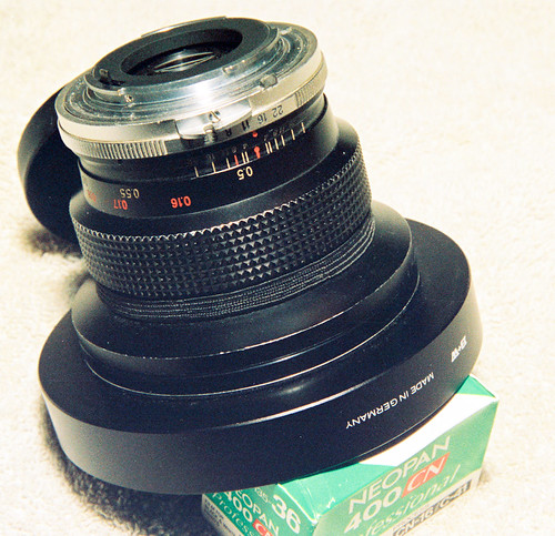

I have the Vivitar 19mm f/3.8 lens in Pentax K mount and it is an amazing lens! I am also stunned at how sharp it is....
url], on Flickr
url], on Flickr

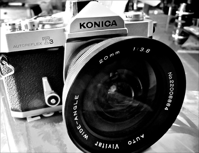

I have the 20mm 3.8 Vivitar in Konica AR mount made by Kiron. I find it an excellent lens. David you can tell the manufacture by the first two digits if it's 22 then it is made by Kiron.
Konica T3 by dbuckle2695, on Flickr

dbuckle: that photo is the identical lens, but in Canon FD mount, not Konica. - David Lyga
OK the serial number for the Vivitar that I now own (Canon FD mount) is: # 22200777. This was made somewhat later than debuckle's which begins # 220... but is otherwise identical. - David Lyga
