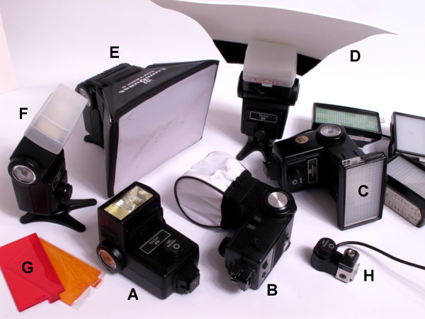

There are 2 great electronic flashes in the flash hall of fame: Sunpak 611 and Vivitar 283 (for those who like shoe mount). Sunpak 611 man since 1976 here.
