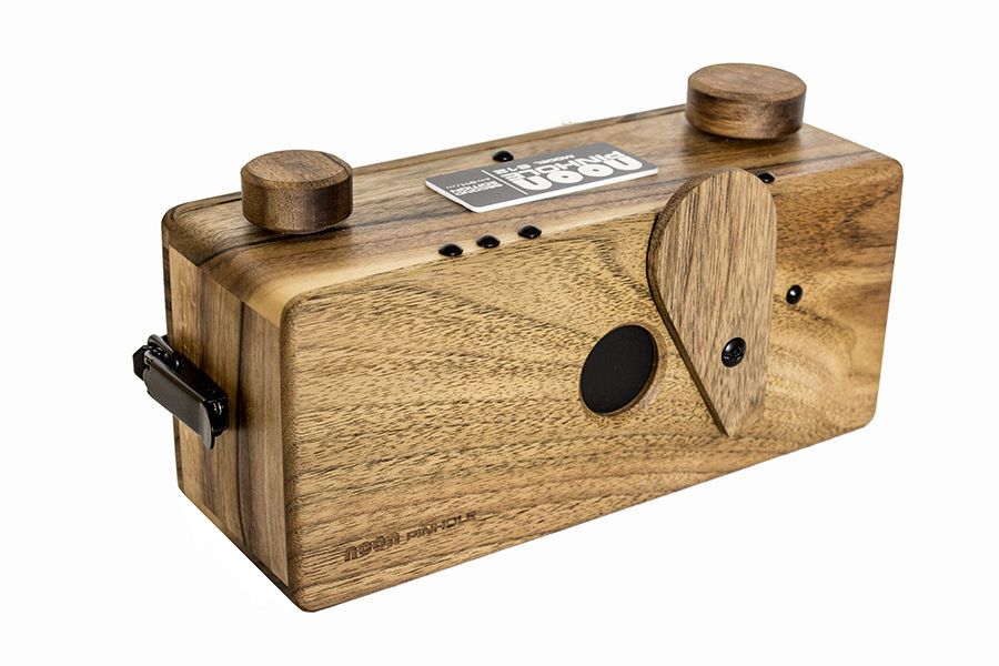

The framing "bumps" on my Noon 6x12 pinhole work quite well, although I would like to have some for the vertical framing too.
NedL
Aug 23, 2012
3,371
Sonoma County, California
I call the bumps Matt is talking about "viewing dots". You can use them to frame vertically or horizontally ( ie. Matt could put bumps on the side of his camera for vertical framing ). Or you can draw "sighting lines" on your camera. Also... once you get used to the angle of view of your camera, you can eyeball it pretty well...
