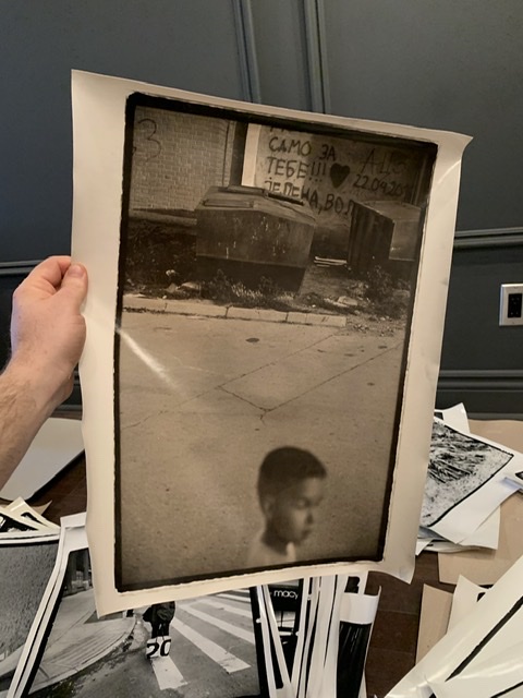

i did not fix until now, but since I’m in a marathon of well over 2000 prints (yeah, printing all my best, ever), I want to make sure that my prints look as good as today when someone opens the huge boxes, in 100 years.
Here’s a print:

Looking at the example print, it almost seems like you've got some serious staining of the whites going on, though. But it could be the lighting. In any case, sepia toning should not change the white border; if it does, it can point to insufficient fixing before toning or insufficient washing between fixing and toning.
Fixing after a sepia toner is not necessary.
serious staining it is. I had this box of fogged papers which I saved with heavy use of Benzotriazole. But still, there were all kinds of weird things happening all along the 50 sheets. Each sheet was a different fight. I was happy to finish that box!
In this case it’s a mix of lighting and the fogged paper getting toned all over. I usially rip bad prints but this batch had this moody and quite unique look. Sometimes (well, always actually) I embrace the look over technical perfection. My fixing and washing are perfect, always! I’m well within archival standards.
