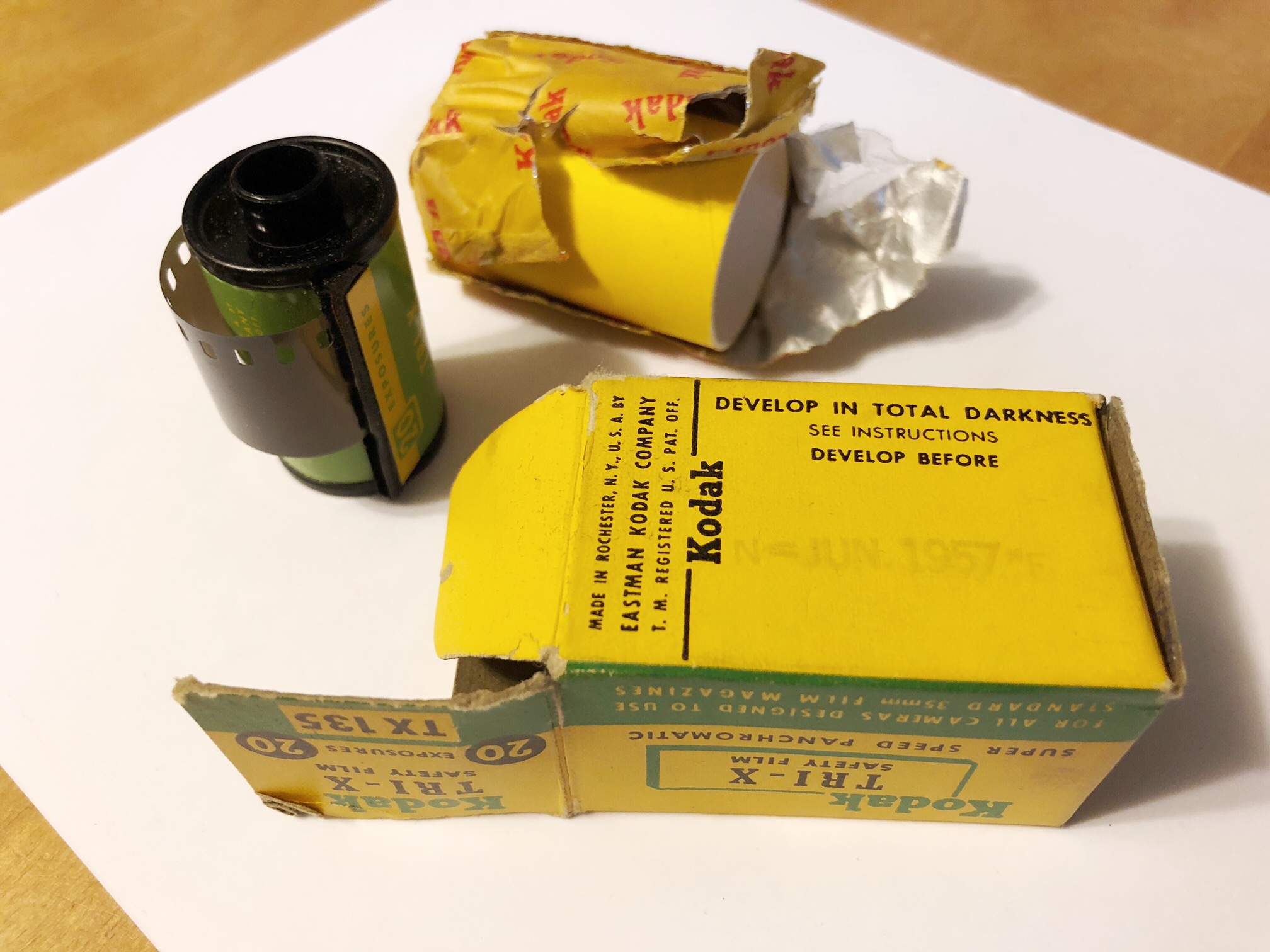

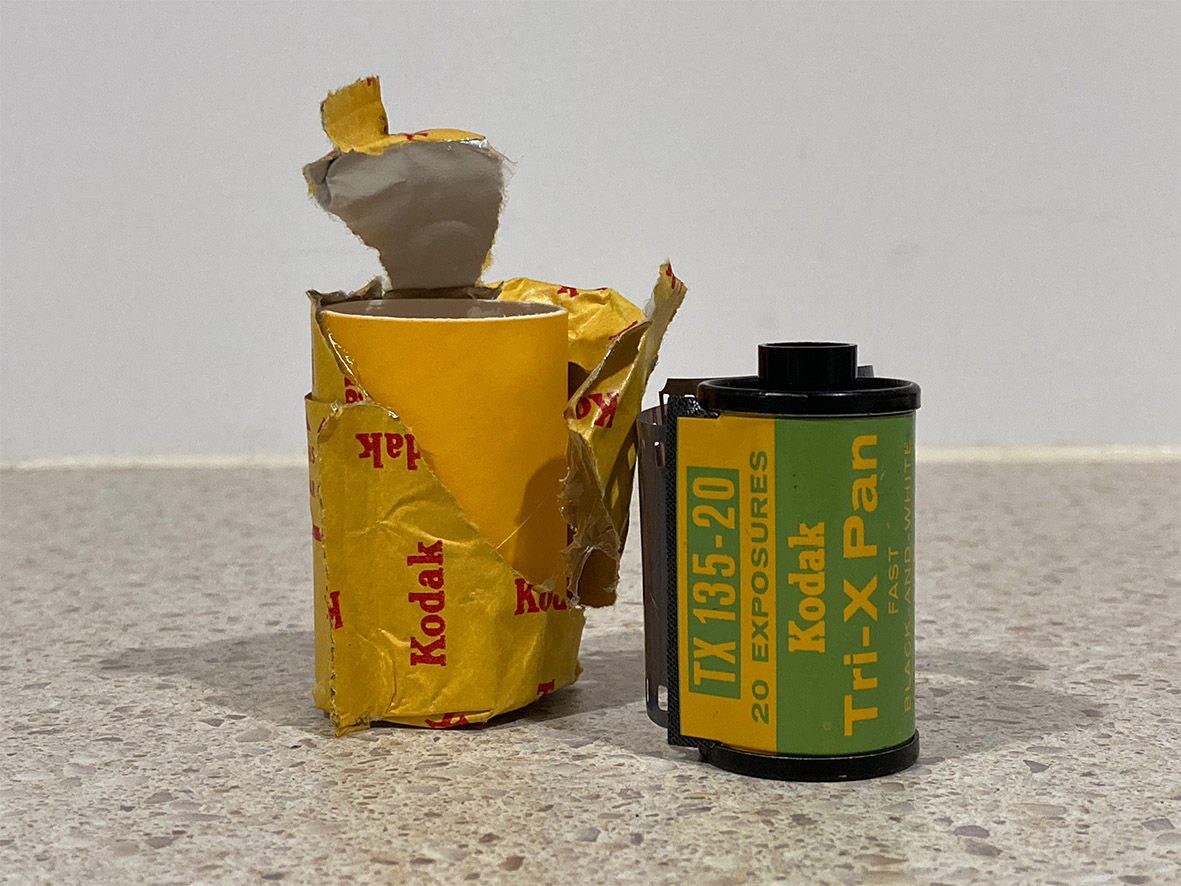

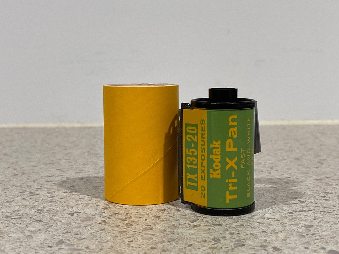

Just been going through my film stocks and came across some Kodak film that was only in its sealed, aluminium foil packaging. At first, I thought it might have been some old 828 in a large container, but upon opening, it revealed itself to be some pretty old 20exp, Tri-X in a cardboard tube.
Seems at some stage, Kodak was pretty environmentally friendly when it came to its packaging! Not only does it have a cardboard tube, but it's also a reusable can. First time I've ever come across this, previously it's been silver screw top cans, coloured screwtop cans and of course, the black tubes with grey lids or black tubes with stickers on the grey or black lids identifying the film.
Any ideas as to its era? Going to acclimatise it and then shoot in the coming weeks while on holiday!!

Have no idea, but I would say prior to the mid-70s. The actual cassette looks like the Tri-X I bought in high school during that era, but Kodak had switched to plastic cans by then.

Not sure when Kodak switched from supplying 20 exposure films to 24 exposures, but that might give an indication of age ? As regards the card packing, might this have been from a bulk
"professional" pack, which did not need the screw-top cans ? I'm sure the cans were used at least in the 1950's, as I still have some of these, and other bits, from my late Father and Grandfather's gear used at that time.

In the States the film would date from the 60's, give or take a decade. At the time Kodak packaged all black & white films in the cardboard sleeves. Color films came in the metal cans, yellow can with a red top was Kodachrome, blue top was Ektachrome and black top (?) was Kodacolor. If the film was packaged in the Antipodes the dates may vary.
The film isn't going to produce any decent results - lots of fog, not much sensitivity. You would be better off selling the unopened packages to someone who collects old film packages. IMAO*, using old film just wastes my time shooting it, developing it and then discarding it.

I bought this film at the local drugstore in the seventies. Cardboard tube and foil wrapped in the box

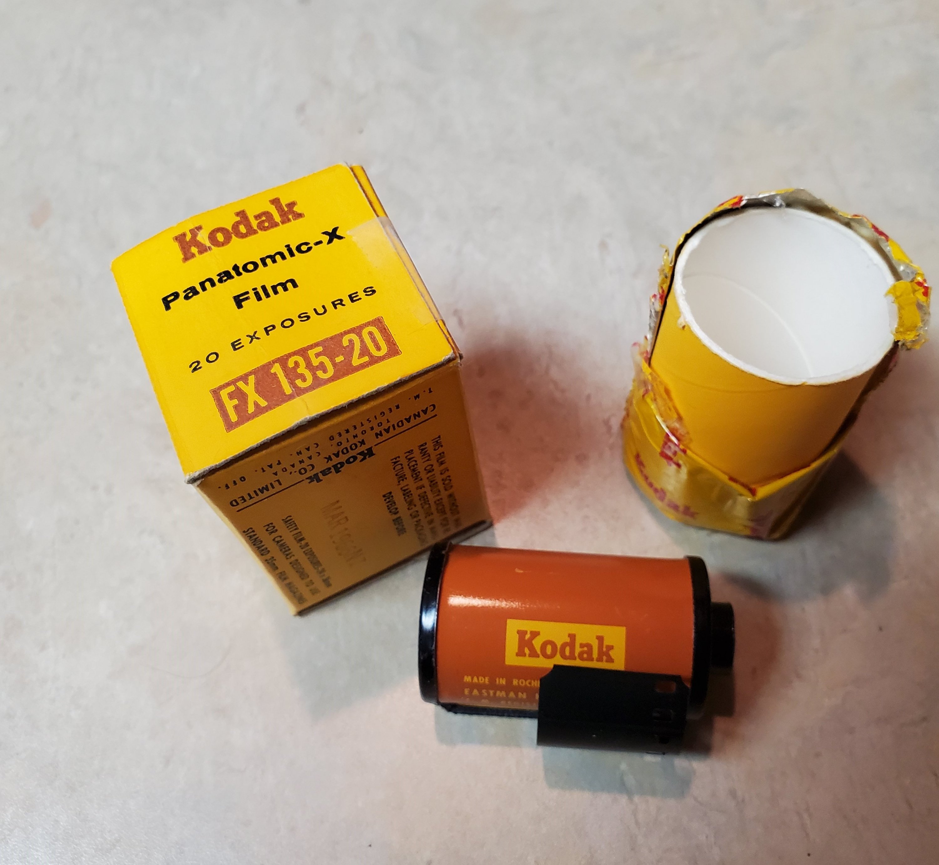

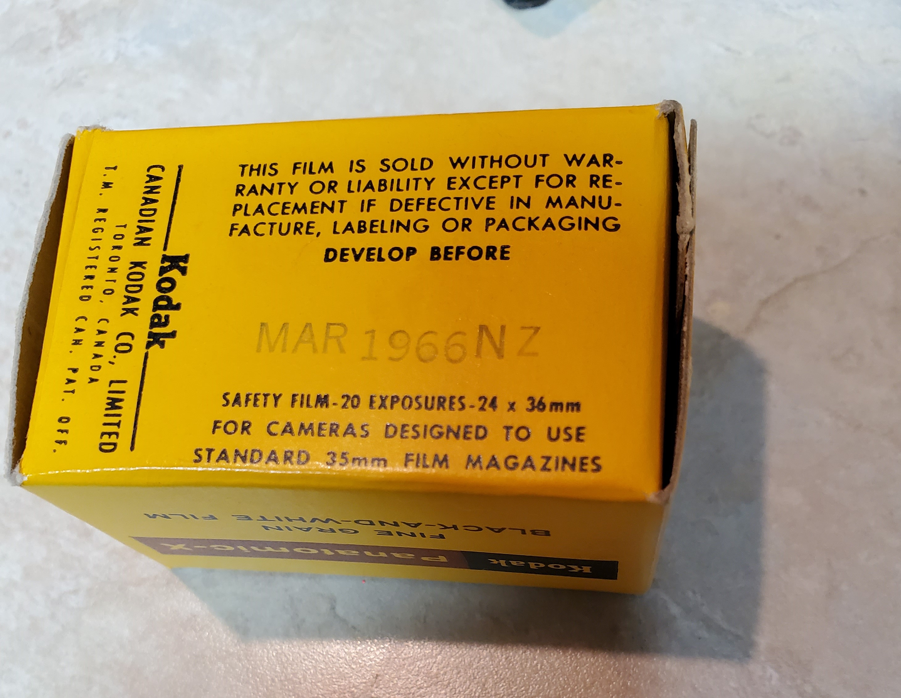

The date may vary for film sold in the Australian market. There are distinct differences in packaging that depend on which market the film was made in, and distributed in.

I would want to say 1950s. When I started using 35mm film in the 60s, they had already switched to an overall yellow cassette, and early 60s is when they started using the crimped cassettes... B&W was often packed in the cardboard tubes and foil. that version of kodak logo was also constant with the 50, as it did change from time to time.
as far as international versions, sometimes the cassette is marked on teh underside where the film comes out with the name of a local subsidiary. (eg Kodak Limited for example)
and yes, I recall using a bulk loaded roll of 1950's tri-x in teh early 70s and barely getting an image for the fog.

This stuff definitely started life in the US, it came in a bunch of rolls a while back. I did think it could be 50s, sadly no box just the solitary roll in foil wrapping only. While it probably is “dead”, I’ll still give it a whirl; sometimes you get a nice surprise.
Hopefully, I can find another roll (or even just the box) to add to my little collection of analog photography items. I’ve got a few that were discarded, simply glued the ends closed and placed on the shelf as little talking points amongst the cameras.
