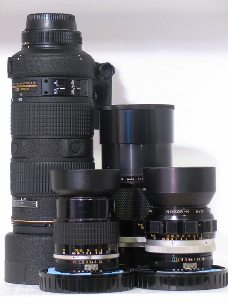

Was Nikon glass more precise back in the day, 60 -70's?
It depends!
At the same focal lengths, my modern 14-24mm f/2.8 Nikkor zoom has better image quality than my vintage 18mm f/3.5, 24mm f/2 prime lenses.
At the same focal lengths, my newer 35-70mm f/2.8 and my 18-55mm f/3.5 to 5.6 produce much better images than the older 43-86mm f/3.5 that I dumped because it produced such crappy images.
At the same focal lengths, my older Nikkor 80-200mm f/2.8 AF S produces image quality equal to the newer 70-200mm f/2.8 AF G.
At the same focal lengths, my older Nikkor 80-200mm f/2.8 AF S produces image quality equal to my vintage 85mm f/1.8, 105mm f/2.5, and 180mm f/2.8 lenses.
https://www.flickr.com/photos/11336821@N00/5259209196/
