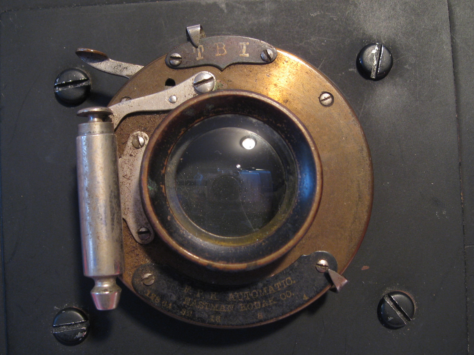

Sorry if this is a dumb question, but...On this old lens, approximately what is the shutter speed in the "I" position? Anything else you can tell me about this lens would be welcomed too.
I've mounted it to a sinar board and was going to experiment/play with it on my 4x5...Thanks

Mine (identical to yours) measures 1/50 after a complete overhaul.

If the lens is a B&L RR, then you may find the lens to be quite nice. I expected softness but got much more sharpness than I ever expected. I shot on color Polaroid (back when it was available) and even the color performance was quite acceptable to me. The aperture is US, not f/stop... if you don't already know.
Even with magnification I can find no markings as to what elements this has. And, no I don't know, what is US aperture?

U.S. stops are Uniform System stops, a different but still usable system of notation. I recently posted this extended conversion table for another member:
Note that the two systems coincide at 16...

B&L markings were on the outside of the front lens cell, in a "gold leaf" that tends to fade or rub off. What did the lens come from, an old Kodak folder?

I got this lens with some other odds and ends. No camera was present. However, I have on display in my office a Kodak N0. 3-A Folding Brownie. This lens/shutter looks pretty much identical. And the one on that camera is clearly marked and is a Rapid rectilinear Bausch & Lomb. I guess I could swap the elements if I wanted too, also.

The one I used was from a 3-A. They come off and go back on really easily... and if I remember correctly they fit directly into a Copal 0 hole.

I've been busy since I last replied...I switched the elements with the ones on the shutter that's on the 3-A. They are much more clear and bright. And since they are marked, I know what they are. It's a win win! Most likely I will try to use the "T" setting to try some longer exposures. And I'll experiment with the "I" setting to see if it's near 1/50 as you (BrianShaw) suggested earlier. I don't have the old time bulb release yet, so I'll have to use a light touch with my finger.
