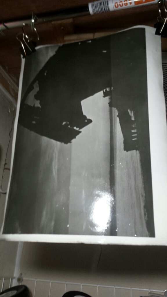

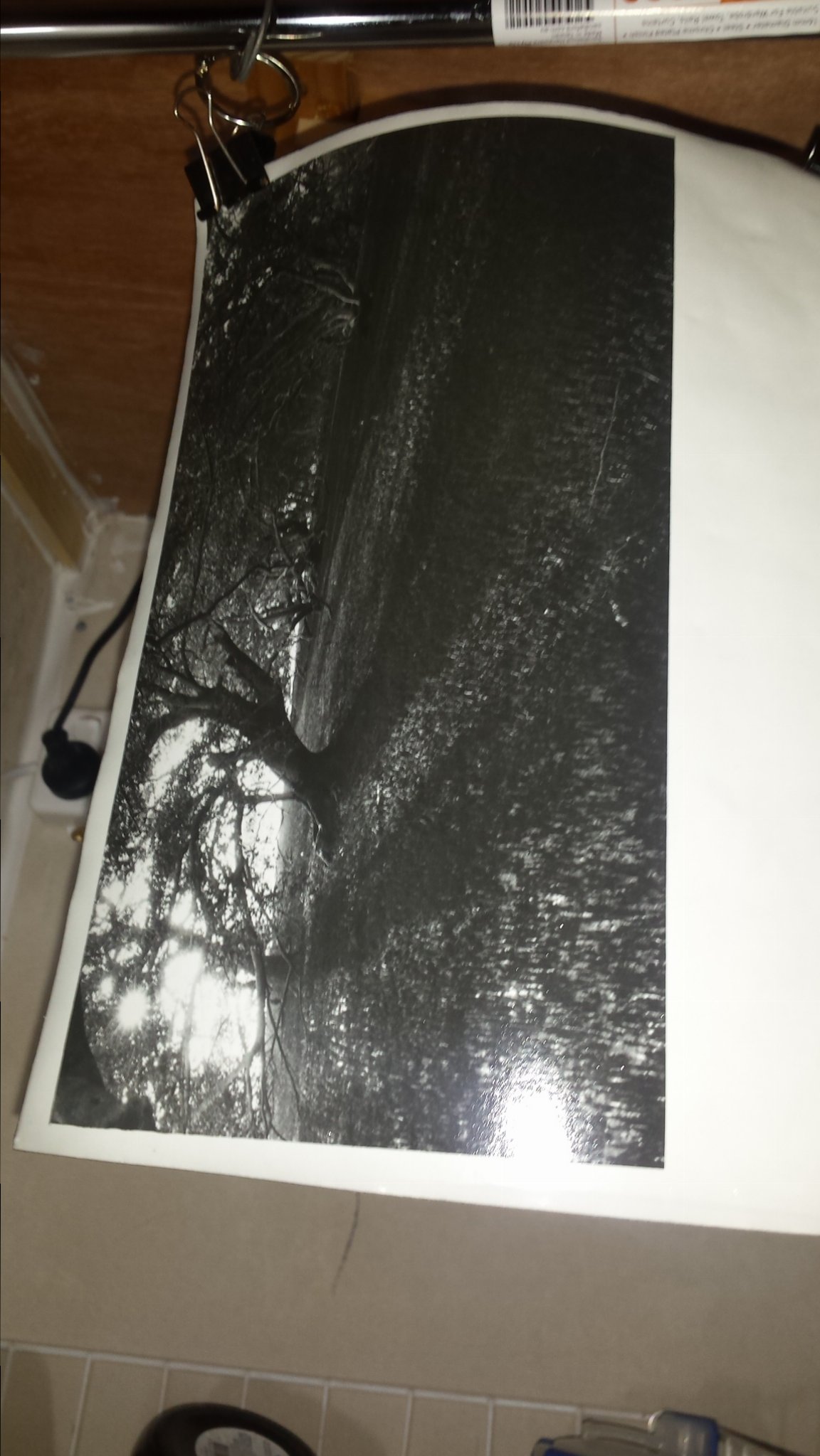

I recently bought a load of obsolete expired film and paper and amongst it was a box of paper marked "Dupoint Defender Varigam 11x14". In it was quite a lot of lose sheets of various sizes, 11x14, 8x10 and some smaller, all are curled along the edges.
I only just completed my dark room and as I didnt have any other paper I though I would try a piece out. I had baths set up with stock formula ilford multi grade and rapid fixer at room temperature @26C cause I was just expecting it to turn black, but to my surprise after a few seconds an image appeared and I decided to take it out of the bath at 40 secs.
I did another few runs and at 20C it would appear that 1.30secs was too long, maybe.
Anyhow Im only new to this and dont have access to chemicals, unless B&H have something appreciate?
Any suggestions for a suitable developer and fixer and times? Box recommends 55-D and 1-F (Acetic Acid) and 11-f
I have film developers, not sure if they are any good, or could I dilute the Multi grade developer more, or something?
Dont have any high expectations, but will be fun experimenting with it.
Thanks

Looks like it escaped fog. The contrast looks good too. You've got a nice box of paper there, legendary in fact. You might check ebay for a filter set for this paper. it's variable contrast. What you have seems to be working fine, you might get some Photographer's Formulary Ansco 130 from B&H. It's a good paper developer IMO. Do some reading through the resources section here and peruse youtube for tips on darkroom work. Honestly I'd set the Varigam aside and work with some cheap student grade paper then come back to this. Here's a good start, the data sheet for your paper developer: http://www.ilfordphoto.com/Webfiles/20061302049381676.pdf

Thanks for the reply Greg.
Was hoping to use them to practice on, guess not. Will do as advised and put them away.
Have been watching and reading, but gets to a point where you want to start making.
The Kodak box above has 72 sheets of still sealed film from WW2, could be toast, but you never know your luck. Will leave until I first find out whats film it actually is and are more competent in its use.

As far as chemicals, what you are using now is probably as good as anything. The paper is, after all, nearly 70 years past its expiration.
