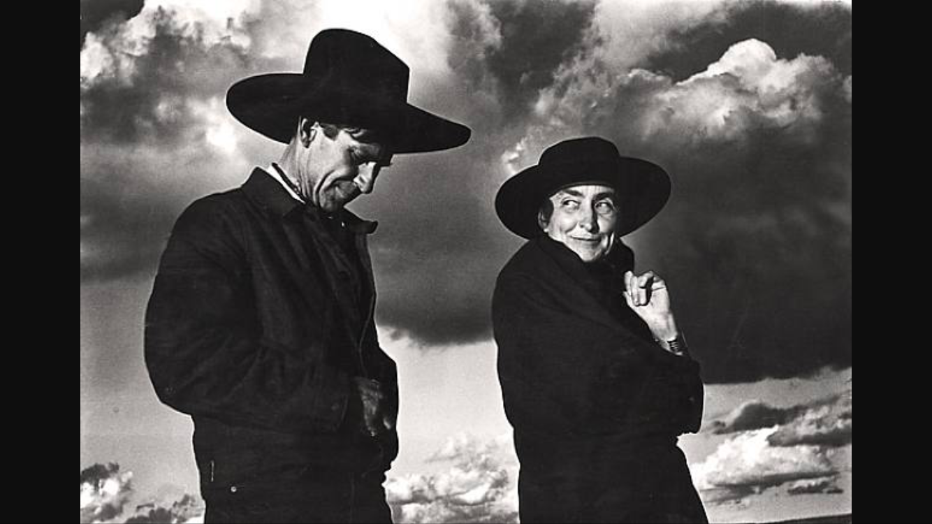

Hi,
I'm restoring a sixties era car and would like to photograph the process and have the images come out with a chalky, sooty, charcoal look. I have an old and a modern lens and Tri -X film that I believe is a step in the right direction. Below are some examples (lifted off google, apologies if I used your image) of the look I'd like to achieve.
1. What filter for the lens? Red? Orange? Yellow? Green, Other?
2. What developer and technique for the film? Rodinal?
What tri -x film speed will result in the grainy, contrasts, sooty look?
Thanks!

The classic photo of Georgia O'Keefe and Orville Cox was taken in 1937, a classic AA photo, reputed to have been shot with a 35mm camera. No TriX back then, most likely Super-XX, which was new that year, and panchromatic. Back then, most films were still orthochromatic, and would give that look you are seeking.

I've seen an original Ansell Adams print of the 3rd image of Georgia O'Keeff and Orville Cox, the tonality bears no resemblance to the attached poor quality version in this thread. Having said tha AA's printing wasn't always that good early on, some of us here in the UK saw a touring exhibition of his work from his daughter collection and many of the prints were nowhere near as good as later prints, I've seen a lot of his work.
The reality is the film and developer will have have less effect than the way the negative is interpreted at the printing stage, with a good negative you can print it anyway you want, a poor negative you struggle.
