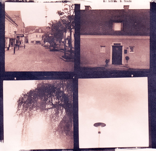

I've toned some in simple green tea with really interesting results. It turned violet which i didn't expect, but i kinda like it. I think i can put an example up sometime today.
edit: here's the pic
Shame the scan isn't really good. The print itself looks much better.
