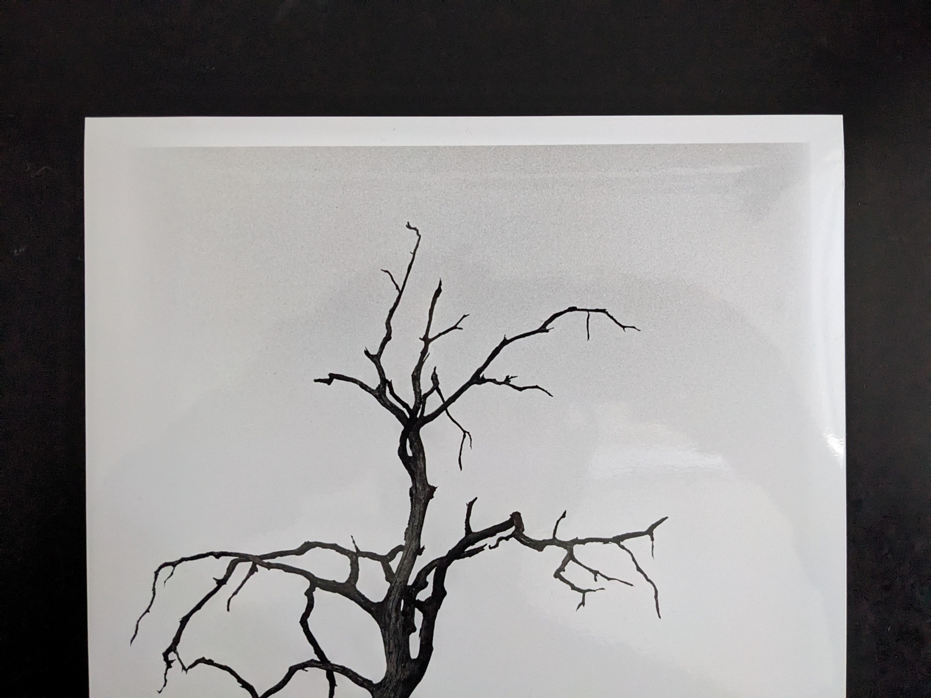

I actually logged on to ask a very similar question about my Omega D5, although when printing 35mm negs I get falloff along one or two edges (and not on every print) and not in the corners like you. I thought it might be alignment though grain seems to be equally sharp across the image so yesterday I aligned the neg carrier, lens and baseboard to within 0.1 degree of each other left to right and front to back using a digital spirit level. I'll do some more printing soon to check whether this has improved the falloff issue.
The opposite corners on your image is strange though. Is the paper flat enough?
I also wondered about using a 50mm on the D5 as I have to use it with the bellows absolutely compacted, maybe an 80mm would be better for 35mm on the D5 unit? Maybe a 105mm on your enlarger would resolve falloff issues?
Here's an example of my falloff problem - more pronounced on the left but present on the right edge as well.

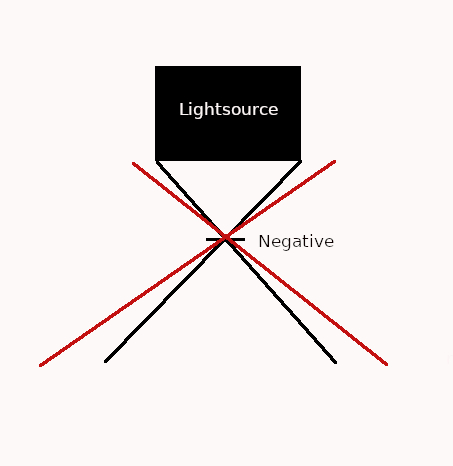

Klaus Mähring
Sep 9, 2007
61
Austria
Here you have a quick illustration why sometimes a longer lens solves the problem of fall off.
The red lines show the angle of a wider lens, and in the case illustrated here the edges are beyond the light source.
