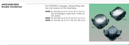

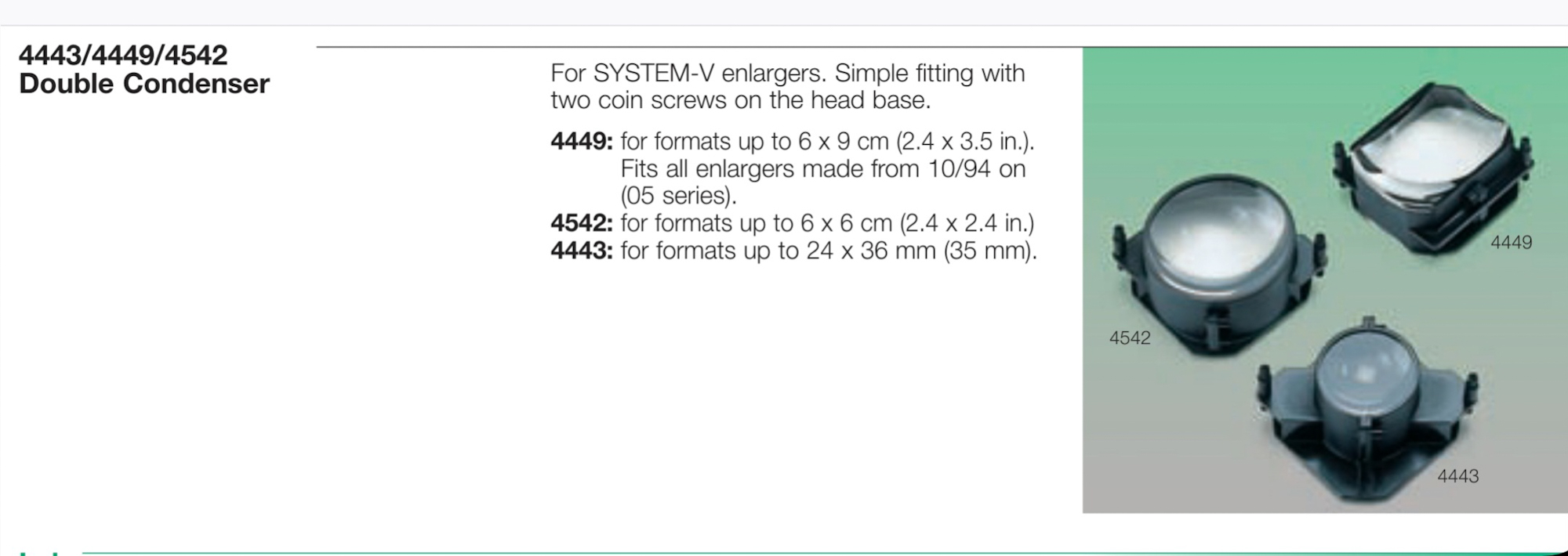

It's not an enlarger I'm familiar with so I had a quick look online.
Which double condensers is the enlarger fitted with? (You'll need to take the head off in order to check)
35mm, upto 6x6, upto 6x9?

My model goes up to 6x7. I’m going to take the double condenser out and see if anything looks off.

If the problem hasn't suddenly started with your enlarger, it may be that the condenser lens was replaced with one that is not compatible with 6x7 (e.g. up to 6x6).

The most obvious cause would be trying to print a 6x7 negative with the 6x6 condenser.
Therefore, a quick check should clarify it.

Just for clarity.
1. The condenser in your enlarger is the 4449 as in the picture I posted?
2. You've printed 6x7 negatives in this exact same set up for the last 15 years and this is a new phenomenon?
