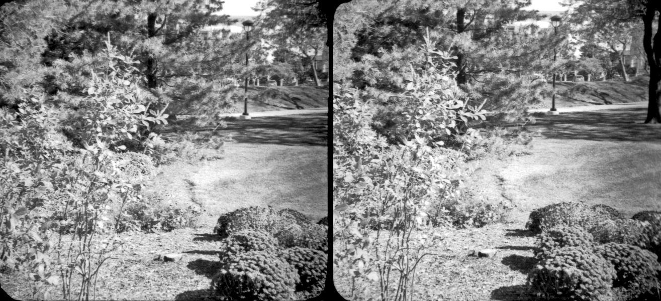

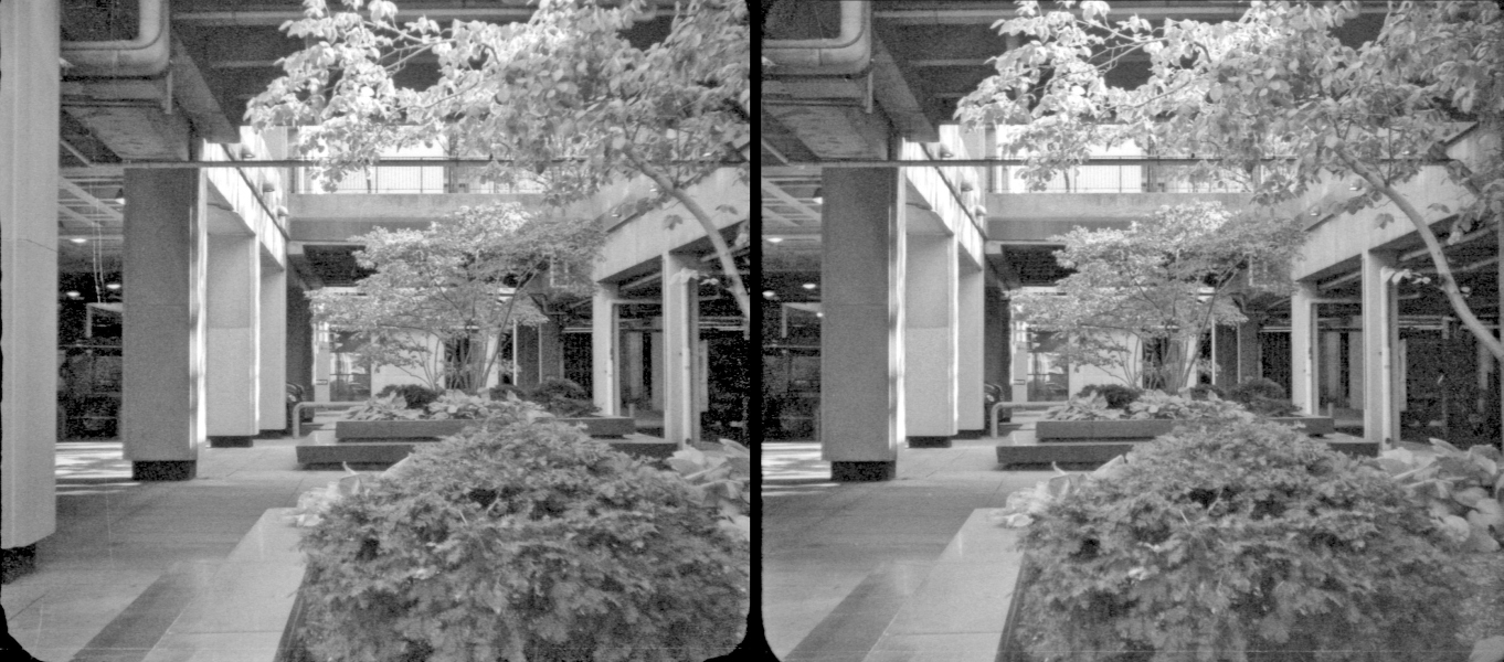

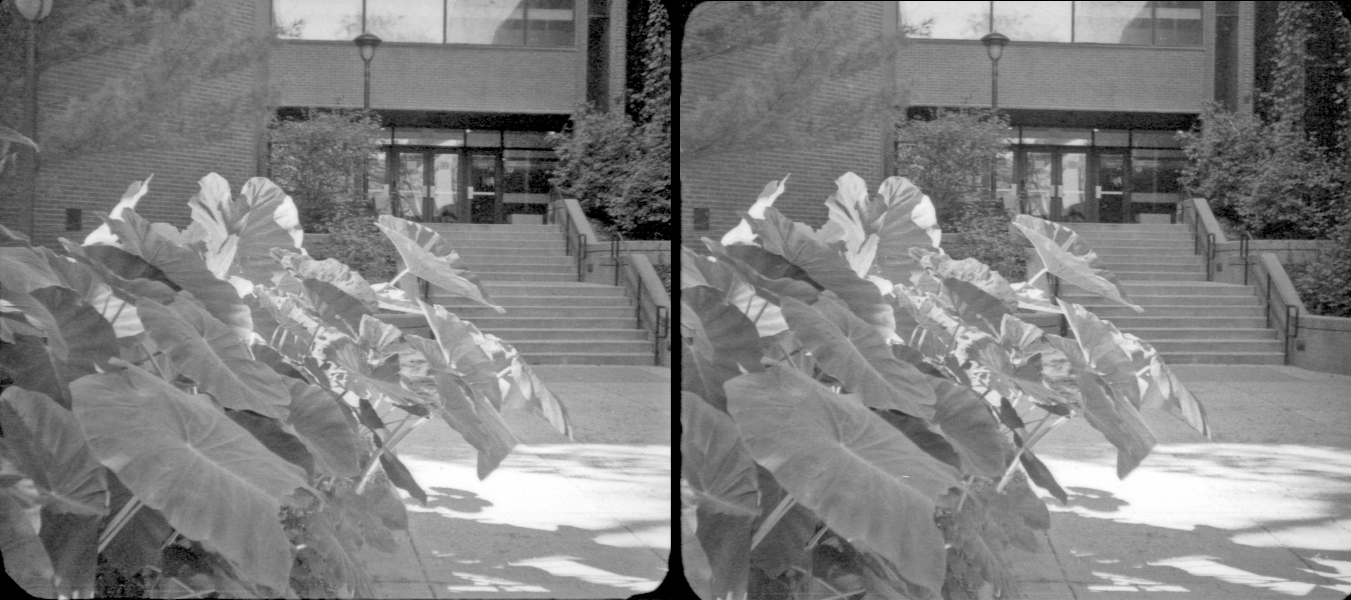

Here are a few quick pictures, meant for cross-eyed viewing. Keep in mind this was a quick-and-dirty test - even the developing. I didn't really do anything more to the scans than a few ImageMagick scripts.
