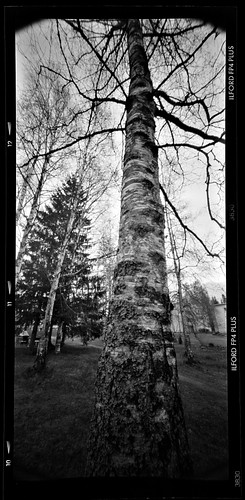

perhaps ... but I'm referring to the Photoshop command to view it full screened

Try doing some reading on sharpening and methods for drawing out more from your neg ... remember ... digital cameras have a "blur" filter above the sensor to remove 'alias' effects ... you can do quite a lot to intelligently sharpen the images from your epson to make them viewable.
Lastly, to illustrate how enlargement is essential to grasp in this equation, the image below is from a pinhole camera, its on 120 film at 6x12 and looks quite sharp contact printed on a postcard, I assure you scans even at 1200 dpi look quite soft
