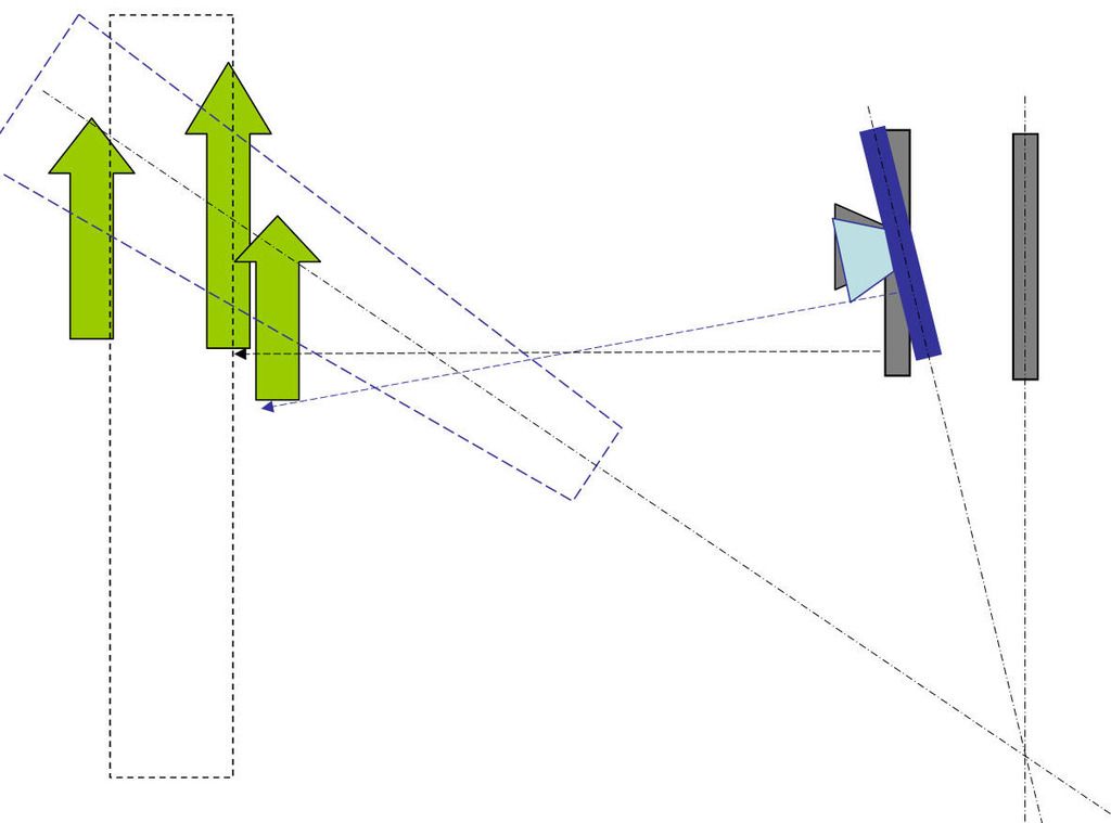

Front tilt moves the plane of focus so it is no longer parallel with the film. The focal plane remains a plane.
Sorta...the Scheimpflug Principle makes DOF zone a trapezoidal shape, with the projected apex at the same point as the intersection of the focus plane w/ lens board plane with film plane. See illustration.
The DOF zone does lay over so that it includes more distance along the ground, but it also cuts off the tops of some trees noticeably (what was in the black box falls outside the blue box).
I will be the first to admit this is not technically 100% correct, but it is intended only the illustrate some of the principle of tilted lens DOF

the problem with illustrations not being drawn to scale is that they can lead to a lot of mis-understanding. The Dof either side of a tall tree is likely much larger than your illustration shows. You might know that and I might know it but anyone just learning LF probably won't.
If you put DoF from half way between camera and tree to same distance behind tree it puts a completely different complection on what will and won't work.
If you've learnt how scheimpflug works properly you can tilt and get tree top in focus but it depends on a lot of variables.
The rodenstock gizmo takes it all into account once you get your head around how to use it. Well worth getting one if you're going to take your LF seriously.
I made no suppositions about shooting aperture, nor the use of Hyperfocal distance. DOF just might have been quite shallow, if the lens was not stopped down a lot, and my primary plane of focus was on a subject standing the opening between trees 2 & 3 (as depicted by the DOF zone placement with the untilted lens standard). And I quickly threw together the illustration, to illustrate a concept of DOF zone on a tilted lens -- but not to illustrate an educational tome, where 100% accuracy is important!

Wilt's graphic above, while not to scale (as Rob points out) does give you the basic idea. As you move the plane of focus from parallel to the standards to tilted from front-to-back in the scene, the DoF moves with it. And, as we all know, DoF is shallower closer to the camera than farther from it, so the shape of the zone of acceptable sharpness becomes trapezoidal.
In you scene, with a tall tree or other vertical object in the center, using front tilt risks leaving the top or the bottom of the tree outside the zone of acceptable focus.
