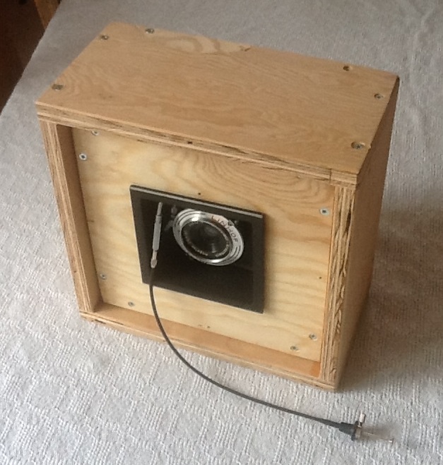

Here's a sliding box in box (to focus) camera with a 90 Angulon on the front and a salvaged 4x5 graflok back on the back.

Frank, that looks like a very rugged and easy camera to use. Please post some images when you get a chance.
