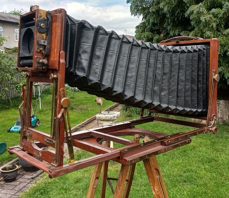

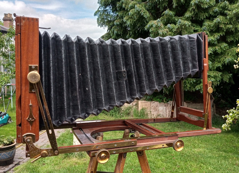

To do what ? I ask this question because they take book form plate holders, half plate film is only available via the Ilford yearlu ULF run and expensive, You could make or adapt a modern back to shoot 7x5 or 5x4 sheet film. An alternative is make an adapter to take a 5x4 DDS film holder that slips in like a book-form holder.
I acquired a Houghton Triple Victo Half Plate camera a couple of weeks ago, mine needs a slight repair, essentially remove a previous piece used to repair it and make a correctnew piece. It joins my Whole Plate Triple Victo and Quarter plate Victo alongside my Half Plate Houghton Duchess.
The cross member that the front standard is screwed to is not original and incorrect thickess so it needs replacing, the images were just quick phone snaps to showw the bellows restoration (before & after) which is completed now.
My point is if you know what you are doing the Victo's are great cameras but maybe not the best to start LF with.
Ian
Wow! thats an impressive bit of rise.

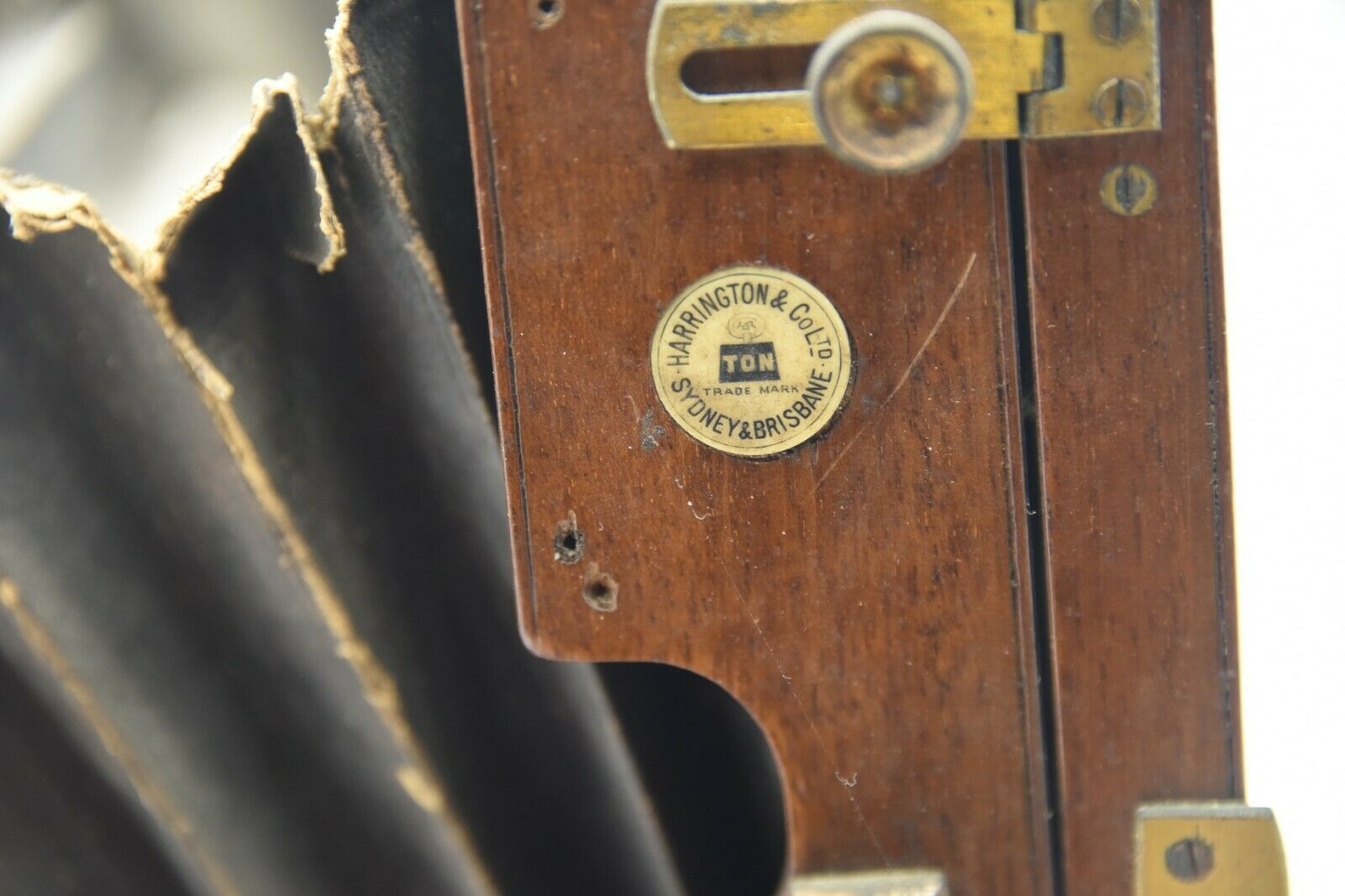

Harringtons Ltd were quite diverse company in their range of activities claiming to be: Manufacturers and importers of everything Photographi, Radio, Cinema and electrica, Jeweller' amd Dentist Requirements. Metallurgists, Analysts and Assayers. Precious Metals Bought and Sold. That's from the 1934 BJP Almanac they had been taken over by Kodak in 1933 probably while the Almanac was at press.
Ian
Thanks. I have a roller blind shutter as well with their logo.
