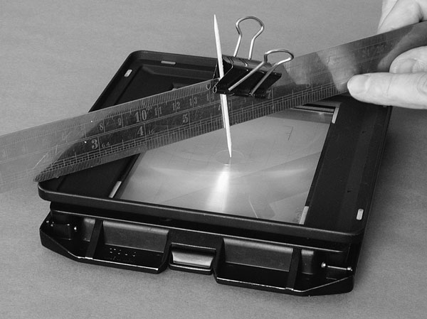

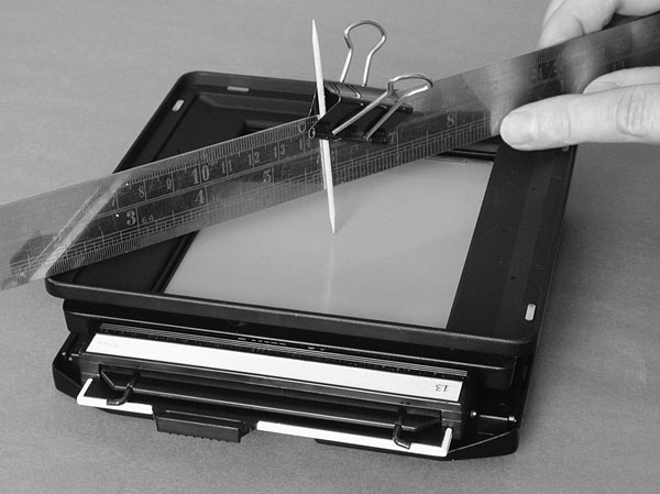

Do what David said. Then, if you don't have a fresnel lens or if it is on the film-side of the glass, test ground glass vs film plane location as shown in the pictures attached. That should tell you what is wrong. If you, however, have a fresnel lens, and it is on the lens-side of the glass, things are bit more difficult.

Hey, Ralph, I have used a ruler to double check the distance to see if they are the same -- but I like you quick and easy toothpick method!

I measured the distance from the camera frame to the ground glass with a vernier scale instead of the toothpick method and got a reading of 6.1cm
Then I put in a holder with a sheet of film and got a reading of 6.2 cm.
Which if I interpret it right it means that the ground glass could be shimmed by 0.1 cm ,which is doable. Does that makes sense?
