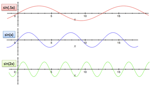

What are the "amplitude" of the scratches?
In any event, you could use "nose grease" or Edwal No-Scratch to hide light base-side scratches.

The peaks don't extend up/down too much. Shallow.
The top wave is more resembling of the scratch, throughout the full length of the film.
