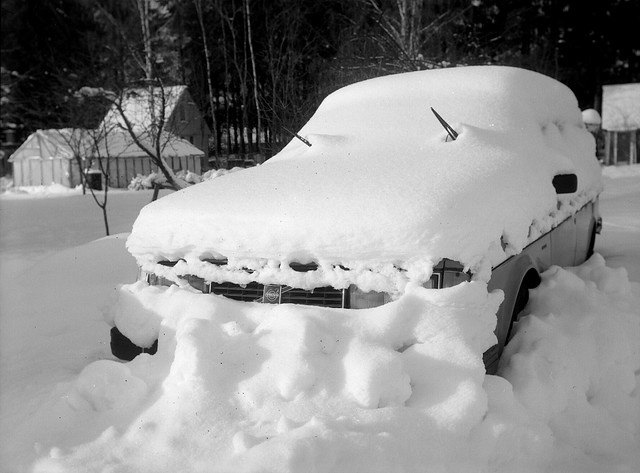

I developed some Perutz P21 (original iso100, shot it at EI25) 9x12cm film, expired in 1968, today morning, very low base fog. OTOH the same emulsion of similar age is deteriorated beyond usability in 120 format.
An example of given P21:
http://www.flickr.com/photos/werra/6901325099/in/photostream/
