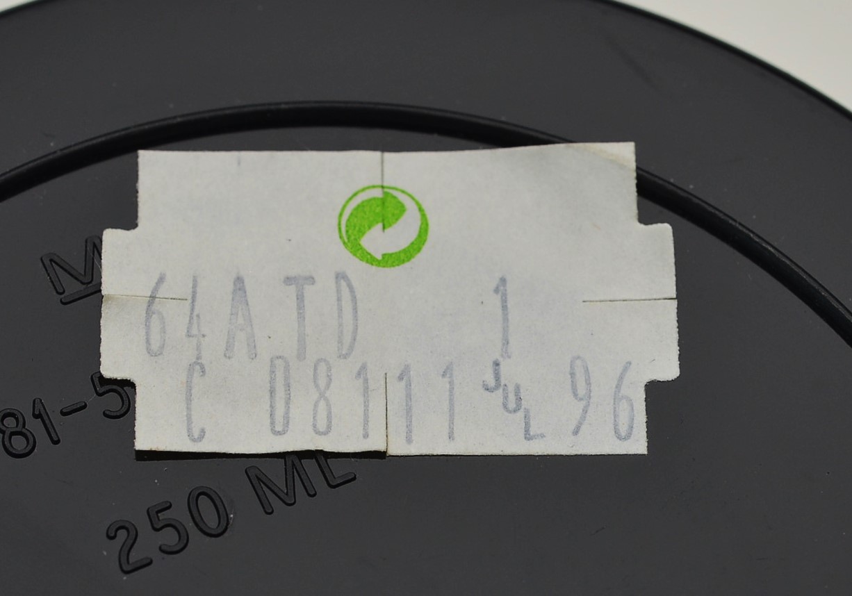

I can't imagine that FOMA film would say "Made in England"
I must have missed that, where in OP does say it was made in England, second post says
"If it says "made in england", its most likely Ilford Delta 400." Has OP confirmed that the packaging says made in England or UK?
In the 90s and ILford, prior to change in ownership after the collapse of the film market ILford did not reband any Ilford products. Same with Kodak, but Foma did.
I'm a firm believer in saying things in pictures.
Can we see photos of as much of the labeling as possible?

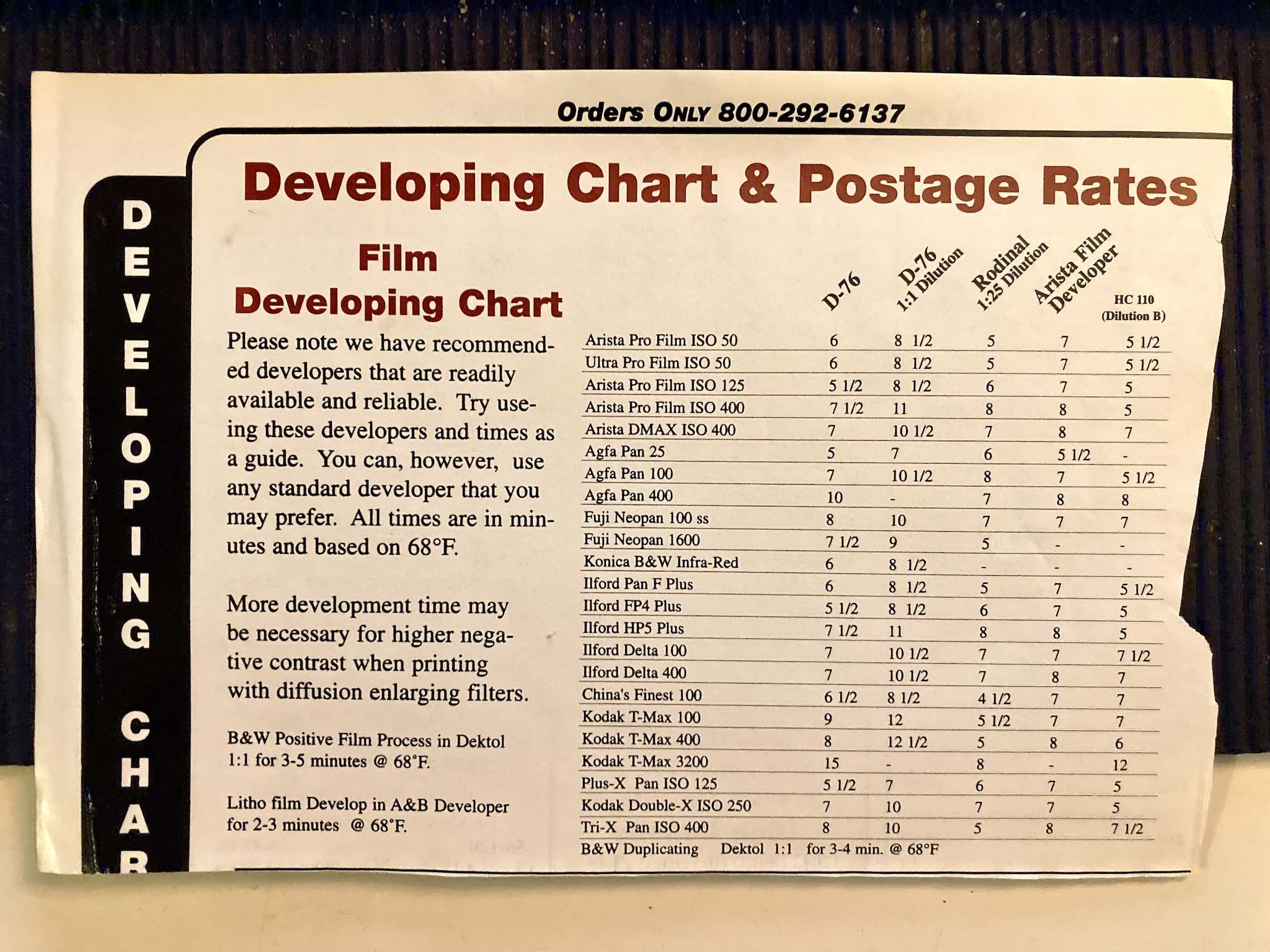

Also relevant here, a few years ago I used the Internet Archive to browse old versions of Freestyle's website, and I retrieved a developing chart from 2001-2002 that has a slightly larger list of films, and also has times for a wider assortment of developers than my precious piece of paper. So for example it does give Xtol and Tmax-RS times (and some other developers no one will ever see again). You can likely find all sorts of odd stuff on the archive.org version of Freestyle's site, but the chart is attached here for posterity.
  • freestyle_2001_film_dev_chart.pdf
I don't believe I'd be using Rodinal on a 400 speed 35mm film. Opting for a D-76 type developer or D-23 should work just fine.
Thanks all for the info on this Film. Reddesert: thanks for the PDF...lots of good info. Matt: I've got some pictures of the film can as you requested 😉 I think that when spring finally springs in WNY, I'm thinking May😆, I will be able to get out and try this old film and will use HC-110 as my first developer. Gkardmw: thanks for the info on Dmax100, it will be interesting to see how well this film has aged. I think that the fact the film has been frozen will help. Once I get the first few rolls processed I'll get back to everyone.

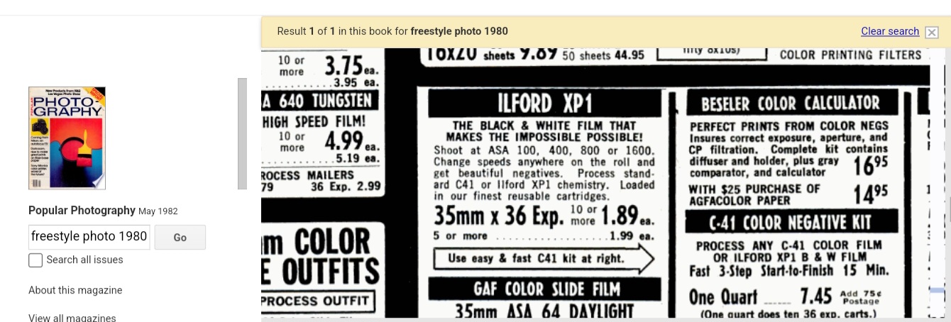

I do have a 35mm roll of Ilford XP1 from the 80's that was "repackaged by FSC" (repackeged by Freestyle Photo). In a May 1982 ad in Pop Photo magazine they even say "loaded in our finest reusable cartridges"
