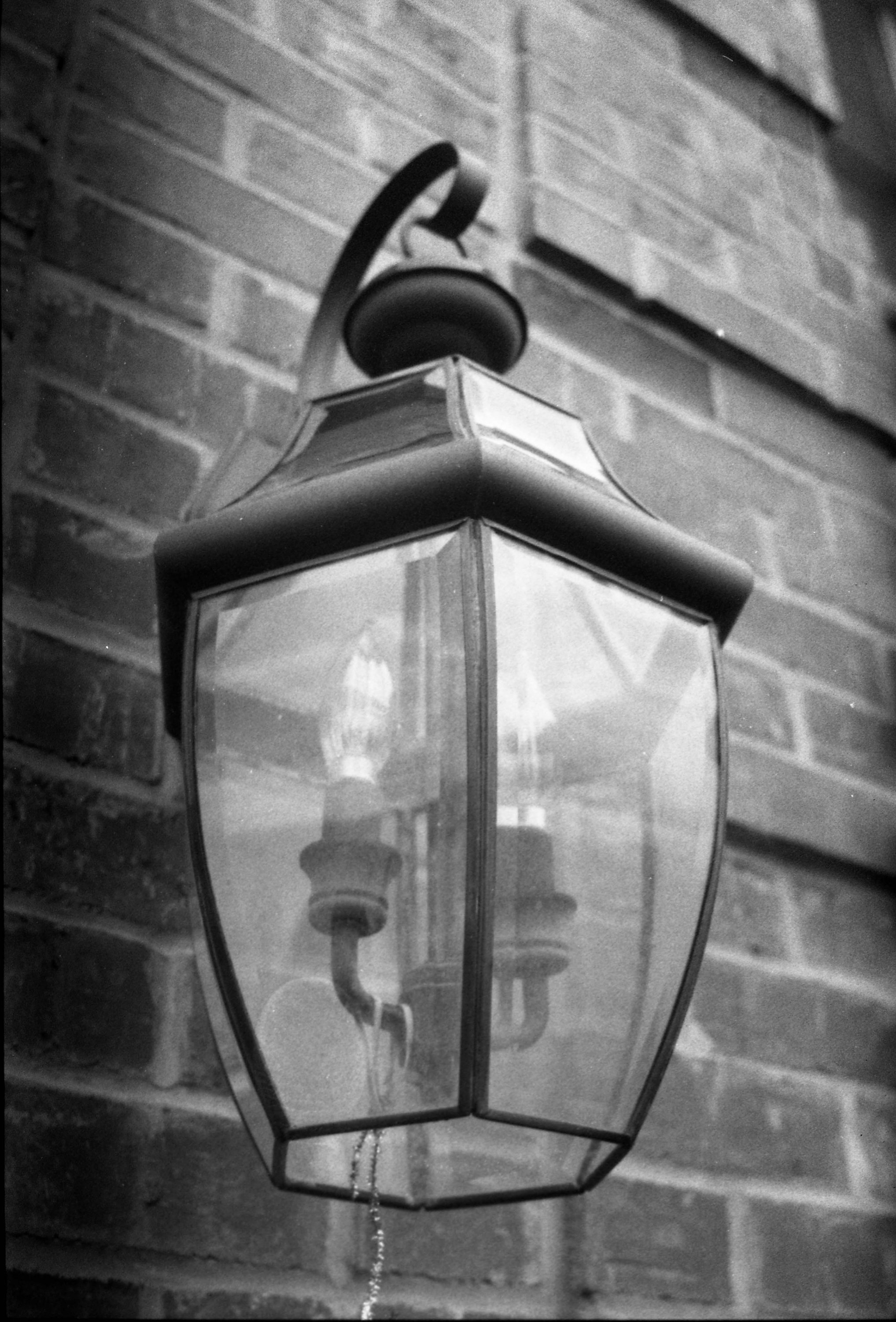

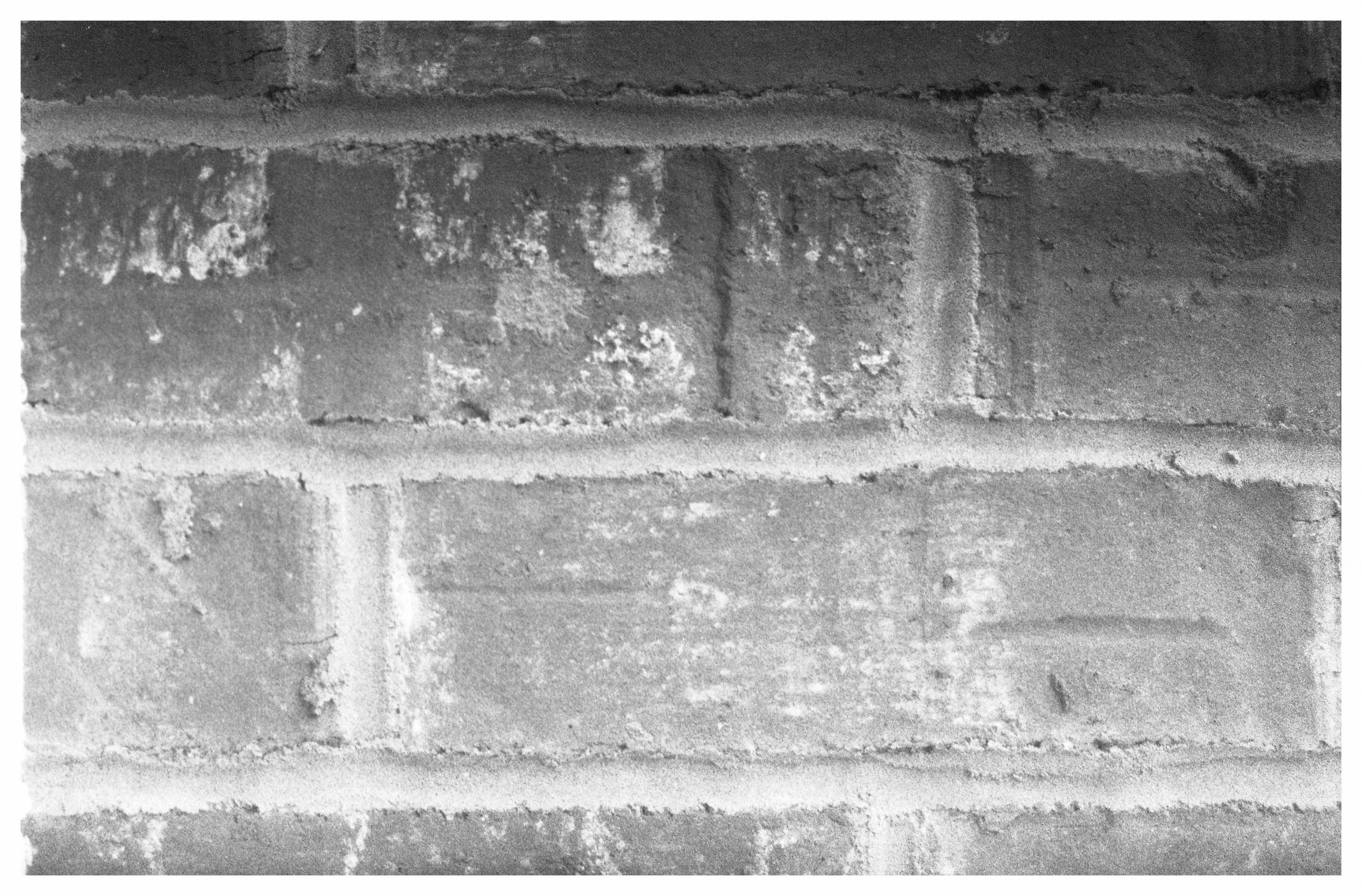

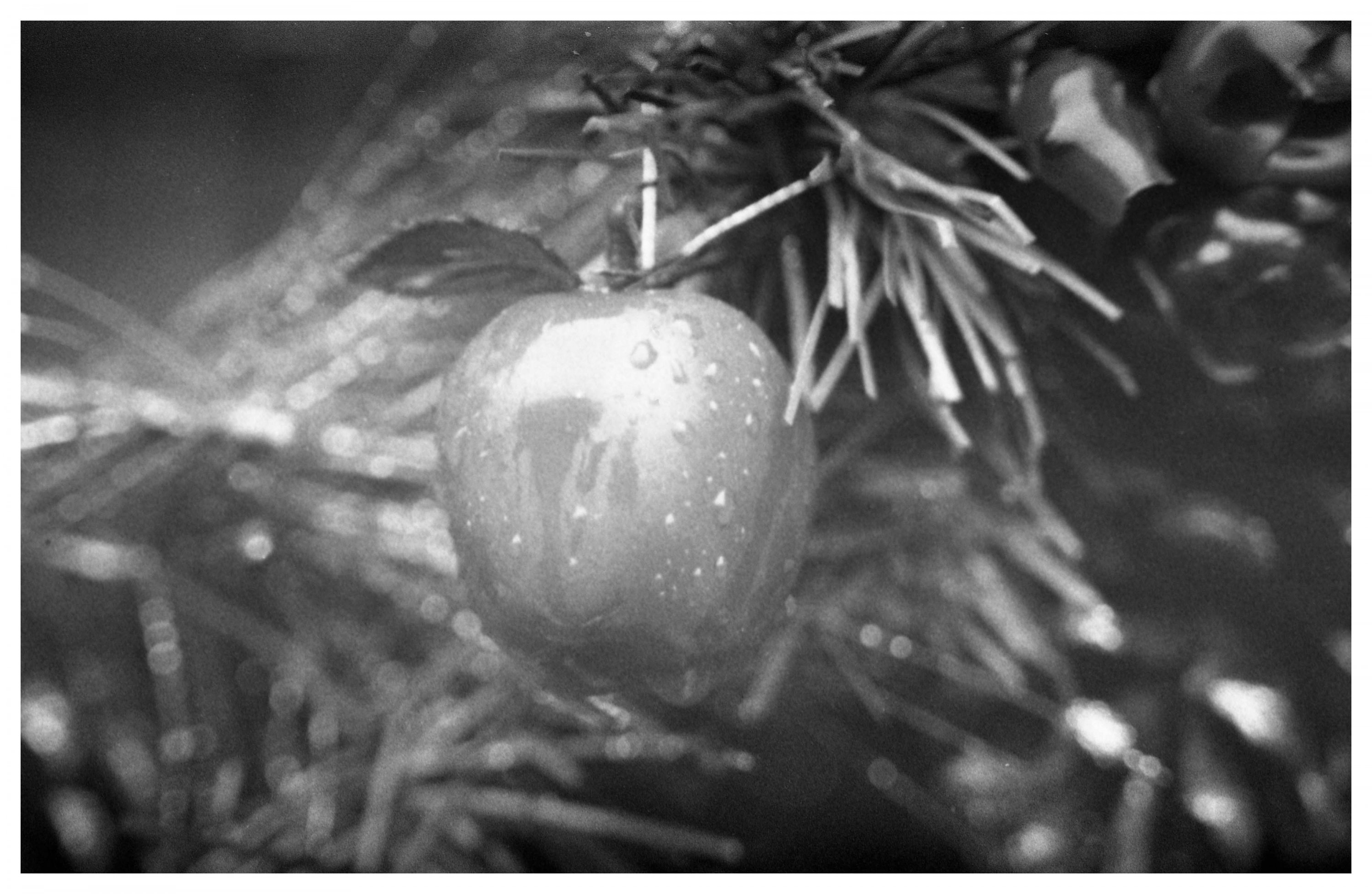

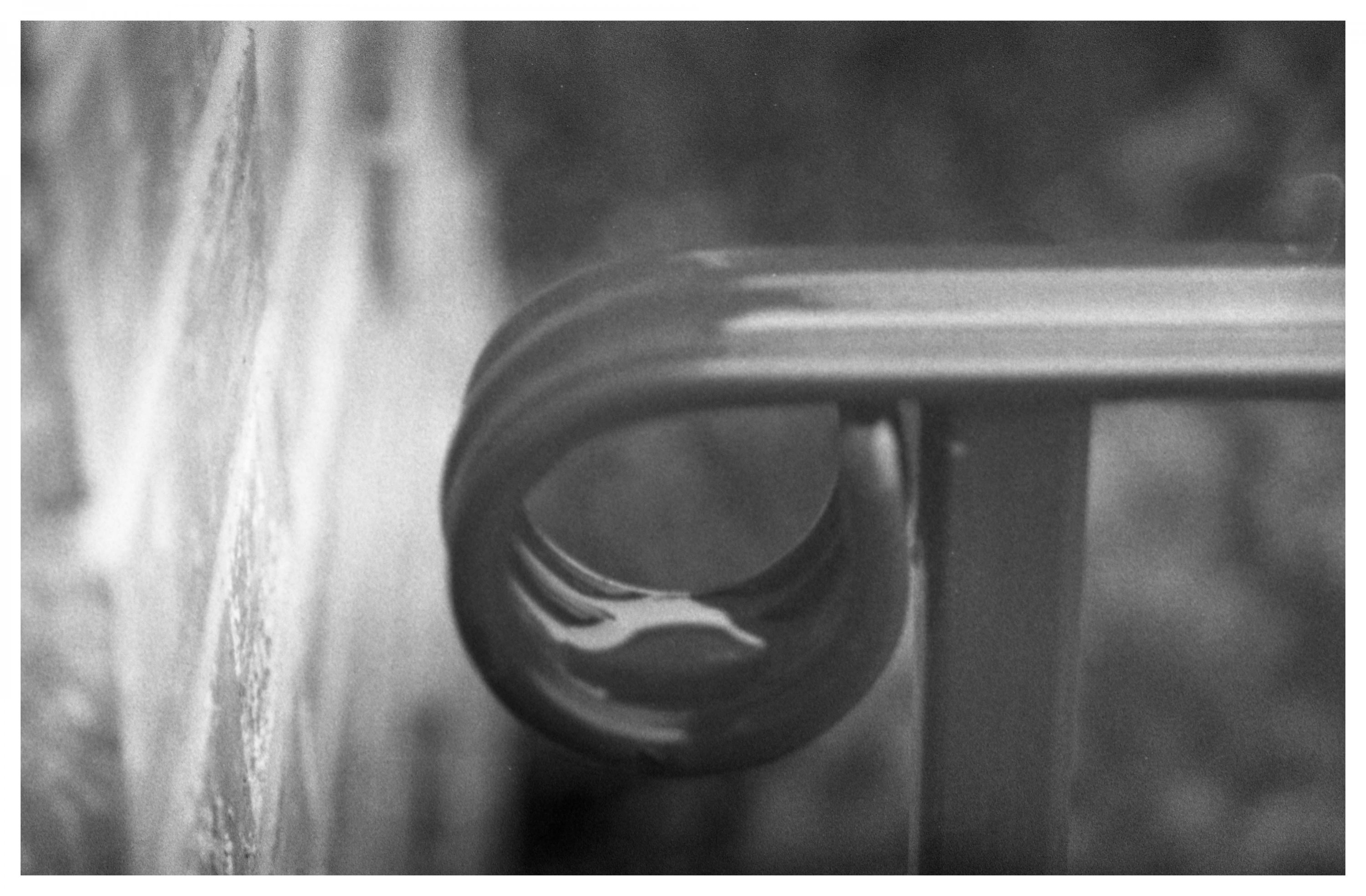

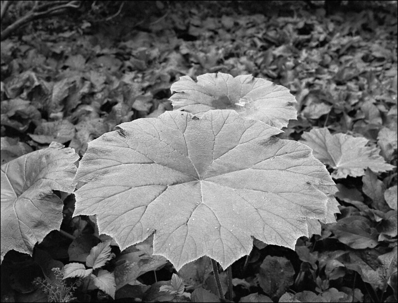

Just like to report back my testing with some old stuff.
The film is Tri-X Pan in a tin can. I loaded into cassette a coupled years ago.
For developer, I mixed 1 GL D-76 in 2014. I stored the stock solution in 1,000ML bottles and stored in basement. Just wanted to try if it is still any good. The stock solution looks like light beer now.
I exposed the film at ISO 100 and developed with regular time.
Here is the result. I'm sure the Epson V750 scanner helps with the auto exposure. I did not do any other processing.
From the negatives, I can see the light leak at the sprocket area. Also there is moderate base fog. I'm just surprised to see that the D-76 stock solution is still very potent after 5 years.
I do not know what I'm going to do with the film. Maybe shoot some panoramic? Also I can add some chemicals to fight the fog.

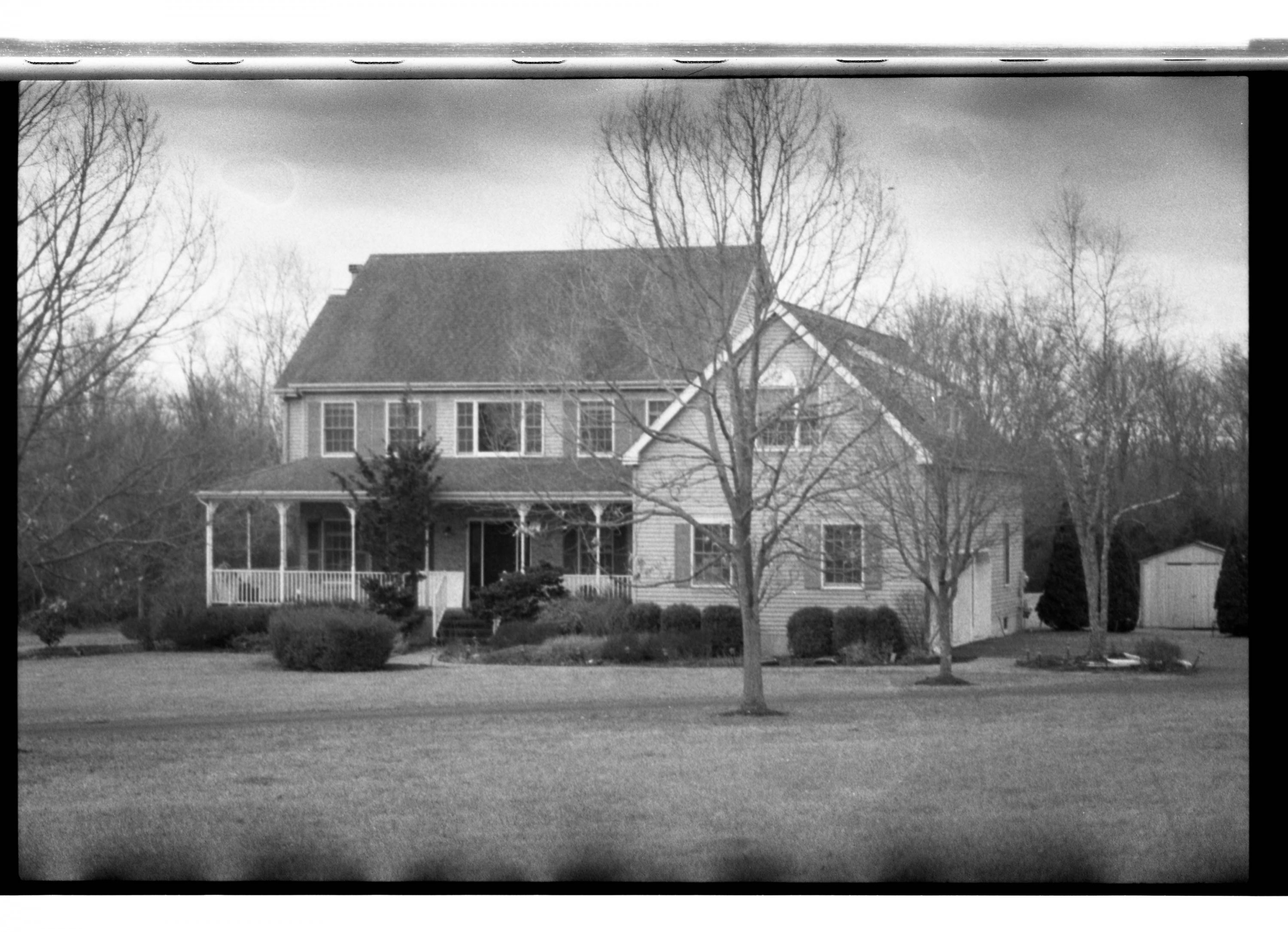

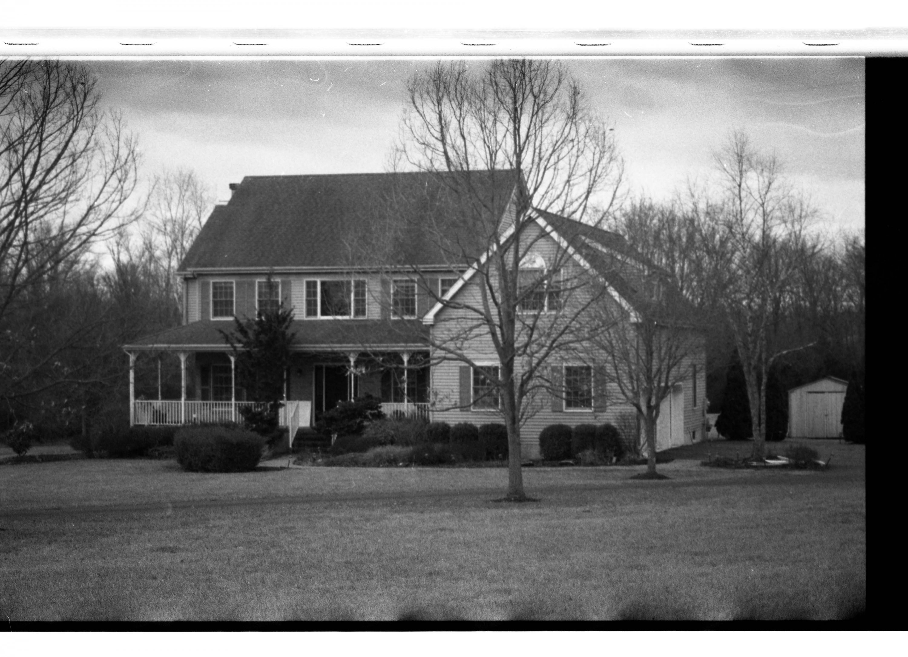

Processed another batch with stock exposure and 1 min more developing time in Jobo. But the negative is thin. So regular exposure with N+1 (or more) does not yield good results.
Need to over exposure for the old film, and over developing to get more contrast.

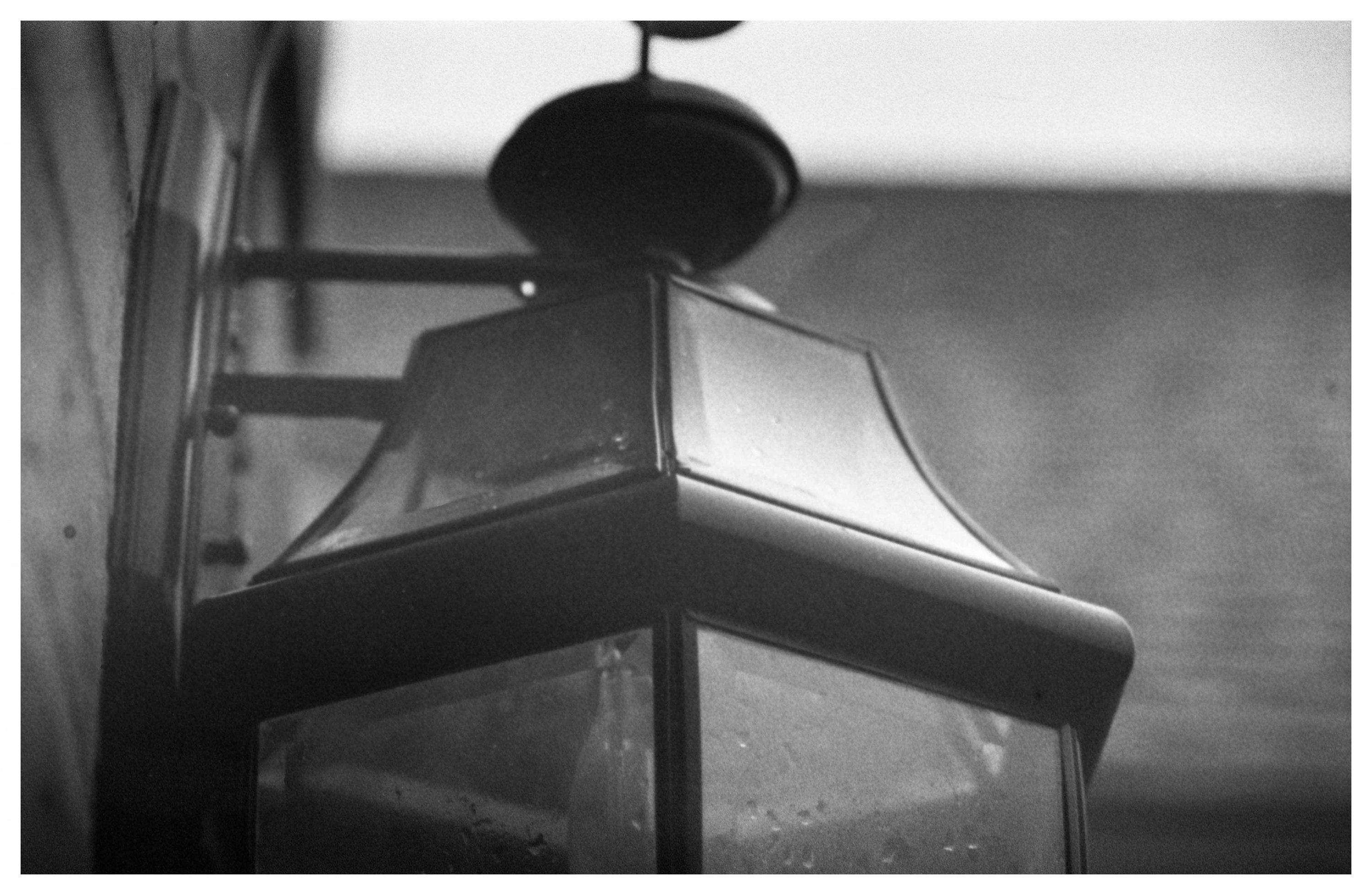

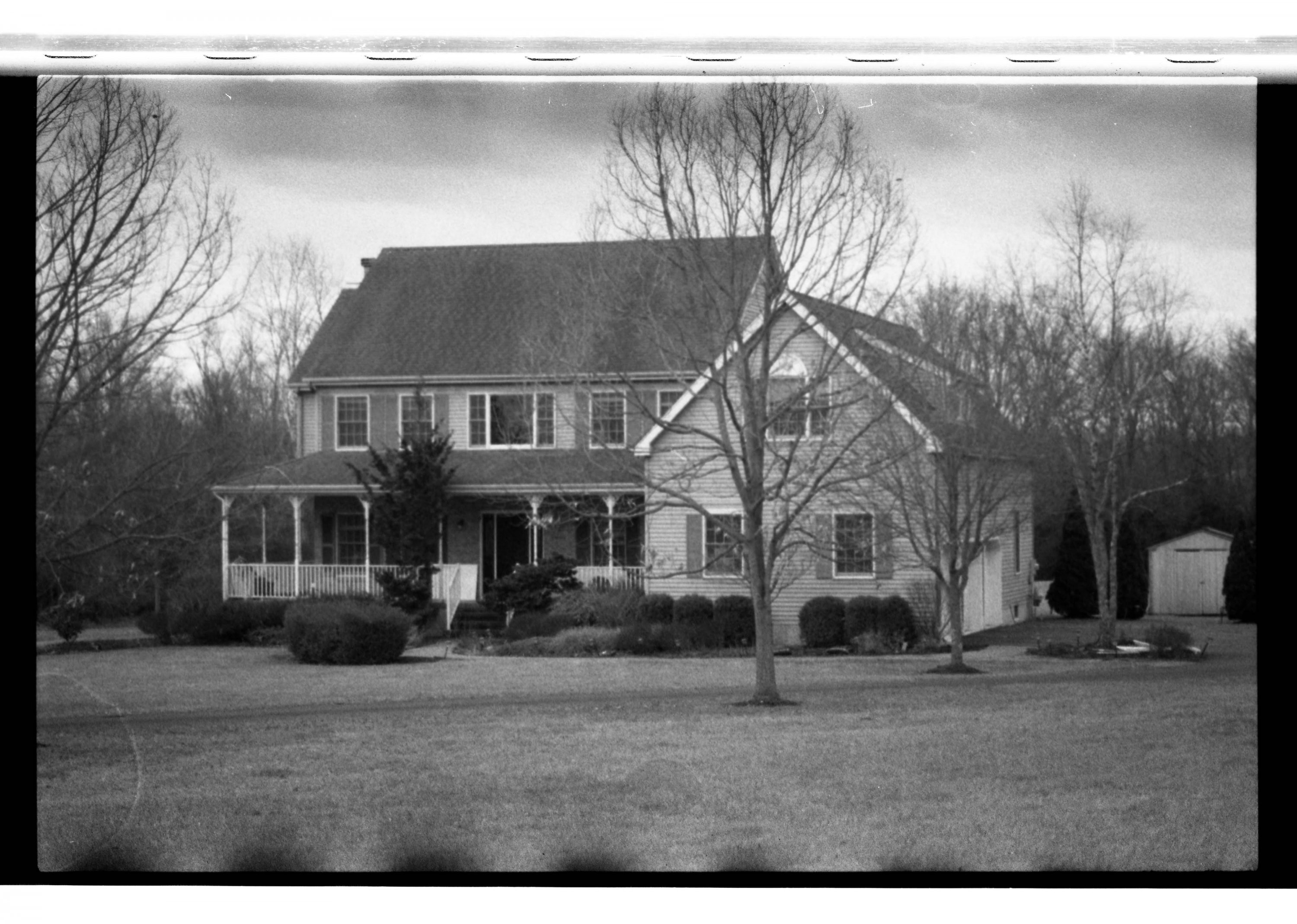

Update on the testing.
Found a 1 QT D-76 powder. Mixed the fresh stock solutions. Decided to shoot the film at EI 25. The film is confirmed as Trix-X Pan film from the imprint on the film edge. There is a lot of speed loss.
Developed at 7 min at 21C, in Jobo with D-76 stock. Results are pretty good. There is some light fog in the sprocket area, but the film is actually clean. The old D-76 stock solution is probably not the problem. Severe film under exposure is the issue.
More one stop bracketing. It seems EI 25 is about right. I did not bother to do a complete wash of the film.
