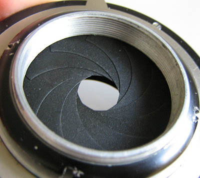

I tried to lubricate the gear axles with tiny amout of oil, but it didn't help, so I decided to clean the shutter in naptha. Since the aperture blades are made of some type of paper, I had to take the shutter mechanism out of the housing.

I thought the repairer could see what I did wrong and correct it. :tongue: All the pieces are in place.
And yes, the aperture blades are indeed paper. Many dial-set Compurs and Compound shutters have paper irises.

BTW: Some Compur and Compound shutters have paper iris blades. I've only seen it on ones I've bought from the USA, never on German or other European buys.

However, yesterday I DID work on a dial-set Compur. This time it was only the anchor in the escapement that needed little naptha to work again. It's for another of my 13,5cm Tessars, so I can still use one if the rim-set Compur above can't be repaired. :D
The mentioned shutters were bought from Germany, came from Zeiss Ikon Maximar cameras, and both have paper irises.

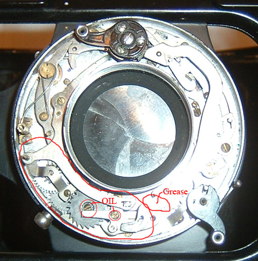

That's a rim-set Compur. The dial-set compur is an entirely different beast, both inside and out:
This is how the thread started:
"So I got this excellent looking early rim-set Compur with a clean 4,5/13,5 Tessar"
SOmewhere I have some info on dial set compurs. I've poked around inside a couple of #2 dial set units. I have a rim set #1 which is slow and I was going to have a try at cleaning it up myself using this guidance but ahven't gotten to it yet.

I have a 1919 16.5 cm Tessar in an early Dial set Compur and that does have metal shutter & iris blades. It's strange that they'd use an inferior material.
Was there a shortage of the metal needed for blades at some stage ?

The paper blades may indeed be a WWII shortage kind of thing - anyone have any other good reason for lack of thin spring steel? :wink:

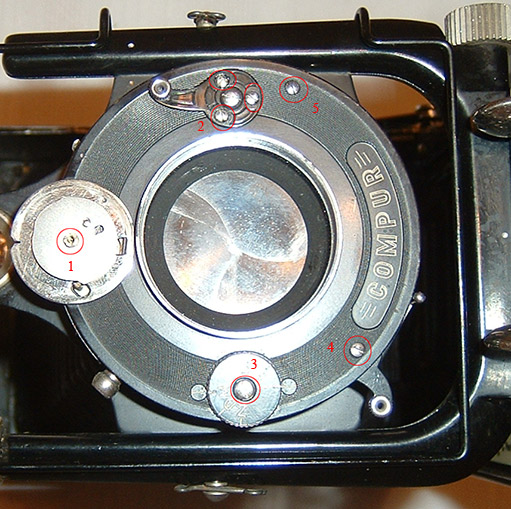

Yes it's a rim-set Compur. The early type with the locking screw for the cover hidden under the aperture scale.
Fotoguy20d, thanks for the link, but I have already been there.
Grrr, no matter how much I try, it looks good but something feels stuck, or the shutter stays open, or all the speeds are the same, or... :mad:
Not sure why they used paper. Maybe because matte black paper scatters less light than blued steel?
No war in 1928, and it was a couple of years after the inflation. I also have a Gauthier Ibsor with paper iris. Maybe we could ask Friedrich Deckel if he remember?
Except this is a 1928 Compur, or is it ? The lens maybe a 1928 Tessar in an newer shutter ? Compur shutters have serial numbers too.
Aren't springs, shutters & aperture blades made from a type of Gun-metal ?
