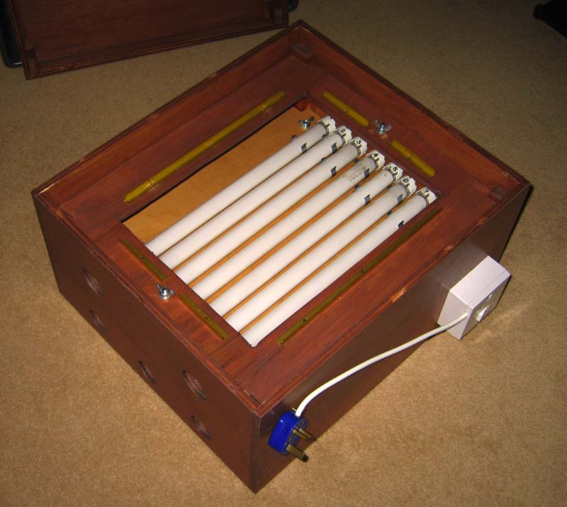

Reading other threads concerning UV print times for various processes it seems that my times are much longer than might be expected, particularly salt prints. They are at present taking anything up to an hour or more. The actual time is more as I have to stop every 15minutes for the contact printer and glass to cool down.
I am using FP4+(PyroPMK) in a frame I made myself which has 6mm Pilkington Optiglass (expensive but, so I was told, has better UV transmission). It IS quicker than ordinary glass!
Attached is a picture of my printer which I made and is fitted with 8 x 15w (total 120w) Philips F15 T8 350 BL UVa tubes. They are about 3inches from the frame glass which measures 11x14 inches.
I am wondering if anyone might have some idea as to why this setup is taking so long to make a print. Should I remove the inner frame which supports the print frame; I don't really see that would make any difference. Another might be to have stronger tubes but that would, I'm sure, only heat everything up even quicker. I could use thinner glass but with the times I'm experiencing now, I can't imagine any great reduction in time would be achieved.

Hi Colin,
I can't see an obvious answer, but it's not clear to me how your lightbox works so may I ask some questions about it?
1) From the picture, it looks to me as if you're projecting the light upwards through glass. Is this correct? This seems like an odd design decision to me because if your negative is in a contact printing frame then you're introducing an extra (and unnecessary) glass layer.
2) This may be a dumb question, but are you sure those are UV tubes? I ask because every UV tube I've seen in recent years has been black not white.
Also, have you tried printing with another lightbox to get a comparison time? I'm half way across the country (Worcester), but you're welcome to use mine if the logistics work. PM me if you're interested.

Along the lines of what Ian says, maybe the bulbs does not output the correct part of the UV spectrum? There is no point in using glass in the box itself. Even if it has good UV transmission, at 6 mm, that's pretty thick. Maybe it also contributes to the heat issues, if it doesn't allow air to circulate. It's enough to have the printing frame glass.

Ian and Jerevan; the aperture above the lamps is simply an open hole, the only glass is in the frame which sits within the brass around the edge.
Ian, I think you may be on the right track concerning the type of tubes. When I bought them I thought I had done enough homework and purchased the right tubes. They are marked as UVA but perhaps it should be the blue coloured ones you suggest which may be UVB (or something else). I shall go off now, make further enquiries and see how I go.
