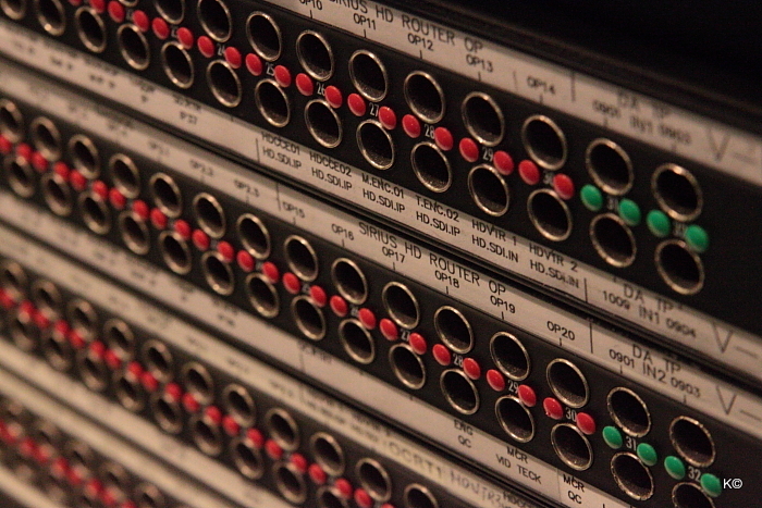

https://photographylife.com/reviews/nikon-d800/6
I have 2008 made Canon 500D. Its maximum ISO is 12800.
I do not hesitate to use it.
I use 6400 regularly.
It is common high iso scare sindrom. I have seen it at forums for decade.
But most of the DSLR or any normal sensor size cameras will provide decent image as long as you are matching ISO and light.
People are using MFT cameras now at ISO 12800.
