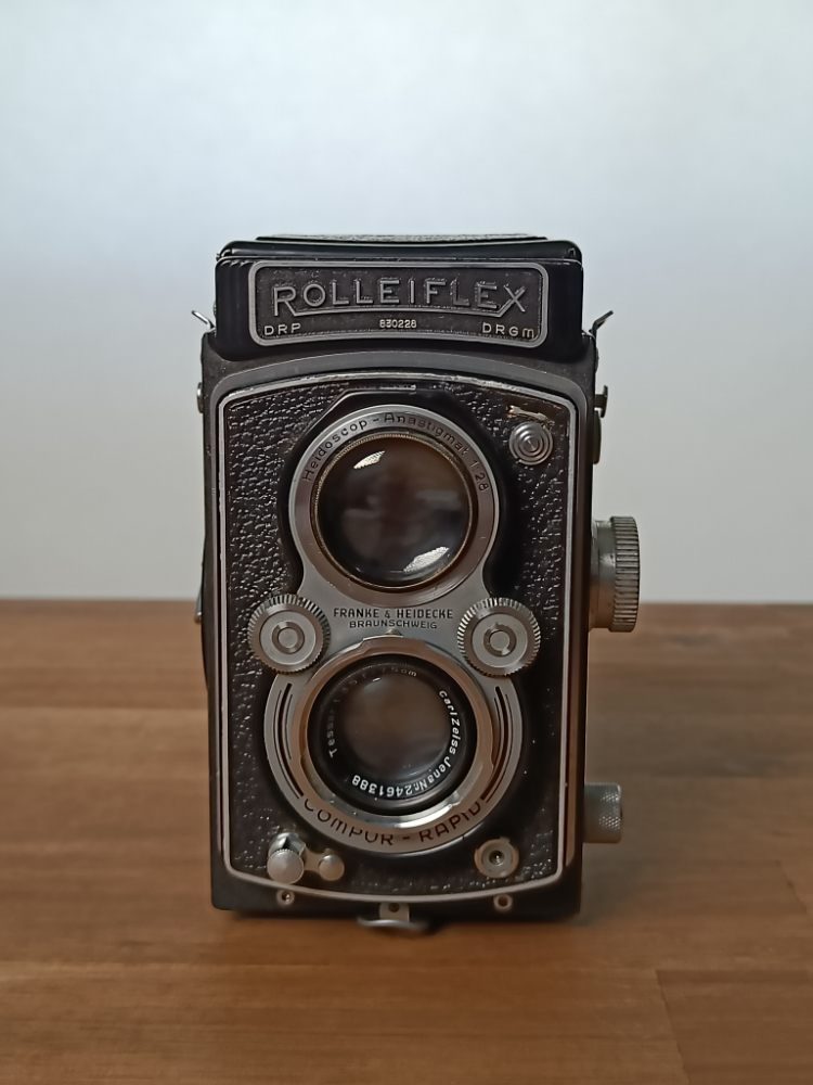

Hello, I have a set of (I think) a very early Rolleiflex automat 1. It looks totally like an Automat 1, but the serialnumber (830228) does not check out.
Could it be a preproduction model?
Would really appreciate some help!
Thanks!
Greetings,
Emanuel

I don't know which sn list you are using but here is a serial number / model list for prewar Rolleiflex:
https://tlr.rolleigraphy.eu/snprewar.php
Rolleiflex models often have overlapping serial number ranges, and according to that page the sn 830nnn could be in the range of either a New Standard or an Automat model 3, presumably because they were making/selling both models at the same time to hit two price points. Yours looks like an Automat (maybe model 1 since I think it has a filter bayonet only on the taking lens). So it's an Automat. I don't think that SN lists are always totally reliable about the small feature differences between different iterations of the same model, that is the seeming inconsistency between SN and whether it's an Automat 1 or 3 is not significant to me (maybe to a Rollei obsessive).
Your camera has the retail packaging and so on (impressive), so I see no reason to think it's an oddball or pre-production.

Thank you for taking the time to help! So I shouldn’t obsess over the serial number? Because it just doesn’t make any sense. As you said, based on the serial, it should be a New Standard or an Automate 3 — but the body looks like an Automate 1, judging by the missing filter thread.

nice, that is a 1938 model, second version of the first Automat.
A K4 631. Indeed your number is higher than usual:
Camera numbers from 610646 to 804999 (so Prochnow says).
For the third version Prochnow lists no. 805000 to 1099999...

It seems to be one of the last ones that had bayonet on the taking lens only. They were all sold as the Automat and there were some changes and improvements during the production that users and collectors call "models" or "types". So yours is an "Automat, type 2" from 1938. The serial number on the taking lens is from the Zeiss 1938 range.
I have an Automat made a little later than yours (856xxx) and it has bayonets on both lenses and a 1938 Tessar.

The serial number on this camera is probably correct (the collector books are not always 100% correct, and the serial numbers overlap), but I have seen some Rolleiflexes that have had the nameplate replaced with a spare part from a donor camera. So that happens too.

Thank you all for your help! I guess the mystery is solved now. It’s an Automat A, model K4 631 – also referred to as a Type 2 – with a late production single bayonet build and not-quite-matching serial numbers.
I will probably sell this set it in the near future. I really wanted to get a 3.5f. :smile:
