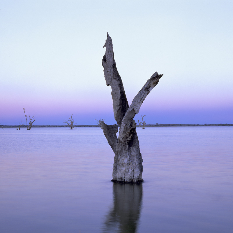

Before moving to medium format I did bracket RVP50 substantially at the rate of around every third or fourth shot of a scene if I absolutely must come back with a printable image (which incidentally requires different metrics to those routinely applied for slides destined for projection only). There is no bracketing now with MF because each shot is multispot metered and the end result is reasonably known through experience -- slightly over-exposed with the meter (not re-rated) to account for print-step brightness lost (depending on the media used).
Velvia to hand, I am returning to this scene (below) next week. It is guaranteed to be hot (40 degrees, as last year) and snake-ridden.
This time I am seeking out a richly-layered blue-pink-blue evening sky and perfectly symmetrical reflection of the tree in the water. It didn't work that way last December, with a breeze through the day persisting into the evening and, dammit, annoying the shits out of me as the shutter was released!
Evening at the Taoist Tree,
Lake Bonney Western shore
Barmera Riverland, South Australia
December 2017
RVP50, Pentax 67 w/ 90mm UV(0), multispot metered 1sec f13
( Cropped from 6x7 to 20x20).

It is actually your beautiful image that inspired me to try velvia :smile: And you're right, under the right conditions the results are beautiful: I did a roll on a very dull and overcast day and the results were really surprising. In direct sunlight, not so much
Thank you. I think anybody could make the same image: irrespective of camera and format, timing is everything, and I came alarmingly close to missng the ideal light due to completely forgetting the interstate time difference!
Crowds do go nuts over that simple composition of a long-dead tree, diddly squat in the shin-deep water of Lake Bonney. Now the time has come to to return to the Lake and make something ... tote amazeballs! Touch wood the sun, moon, planets and stars all align and the lethal snakes ignore me. Hope I'm not asking too much...:errm:
