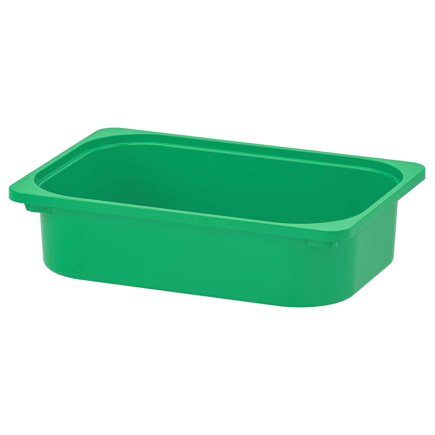

A possible Ikea option;
11x14 would be a bit tight and the shelf/box units for the Trofast trays are more expensive than I thought.
