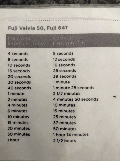

Here is an example of one of my Velvia 50 long exposures
Also, here is my Velvia reciprocity chart
