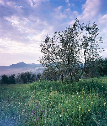

Excusing the fogging in bottom left, here is the same scene in RVP100 and then RVP50. Due to the volume of film I shot in Tuscany, and that I was scrounging the new film from another photographer, I cannot remember exact details, but think that the RVP100 has a 0.6 grad and the RVP50 had a 0.9, but were in pretty quick succession. The scans are low res and haven't had any photoshop processing, just same scanner settings after establishing true black from the rebate.
I have some more RVP100 and will be doing more controlled testing in the coming weeks.

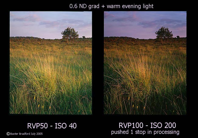

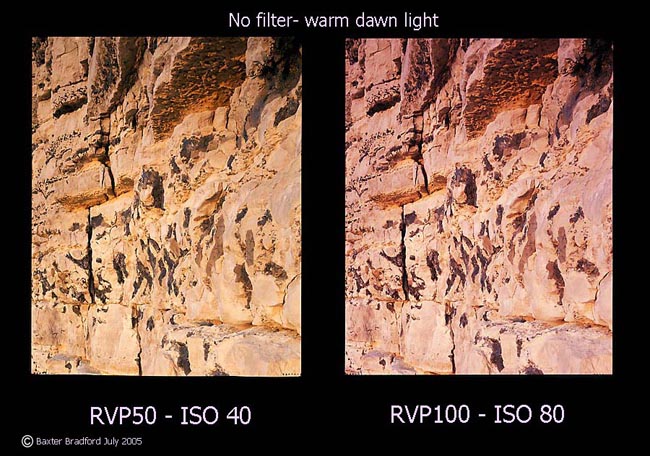

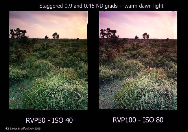

Here are the latest results of my tests. As you can see, I spent a bit of time placing side by side and labelling. Have had to resize to meet upload requirements. Still you should be able to see what is going on. Shots were taken one after the other in stable lighting conditions.
Scans were dome at same settings, except that I used the shadow dropper tool in the rebate for each image in order to determine a true black. The images look about right on my monitor (D50 and gamma 2.2), but in any case you can do a comparison.
ISO 80 seems a bit light, so ISO 100 would be better. For the 1 stop push, I used ISO 200, whereas ISO 160 would have been better!
Am very concerned about the unpredictability of the treatment of skies. The red-ness also comes into the shot of the cliff in the warm dawn sunlight. More so in some tonal areas than others.
I have now uploaded these to the Technical gallery
I shot early afternoon yesterday in a comparison with RVP100F. Will see how the sky is rendered in the colder light.

DO you think you did not give enough exposure to the new Velvia? Not questioning your methods but my use of the old velvia is reddish when I underexpose too much. If you nailed it then these are two widely different films.

I would suggest that you send a couple of sheets of the RVP100 ahead of the batch to see if it is behaving as you would want. I know this sounds pedantic, but performance of RVP when shooting at either end of the day, as you do, is not as what many would wish, especially in the skies. Here it produces incredible (ie not credible) results. There are many UK LF shooters who, like myself having tested the new film, are less than enamoured.
My photo library is not relishing the postproduction work incurred in Photoshop removing reds/magentas from those who supply trannies only to them. They love images shot on RVP50.
As for the NZ trip, you will want to be certain that you are obtaining the results you desire.
On my recent 2 week trip to Cornwall, I shot just 1 sheet of RVP100 and over 80 RVP50! Am seriously looking at using colour neg film as an alternative and shot 15 sheets of this in readiness.
