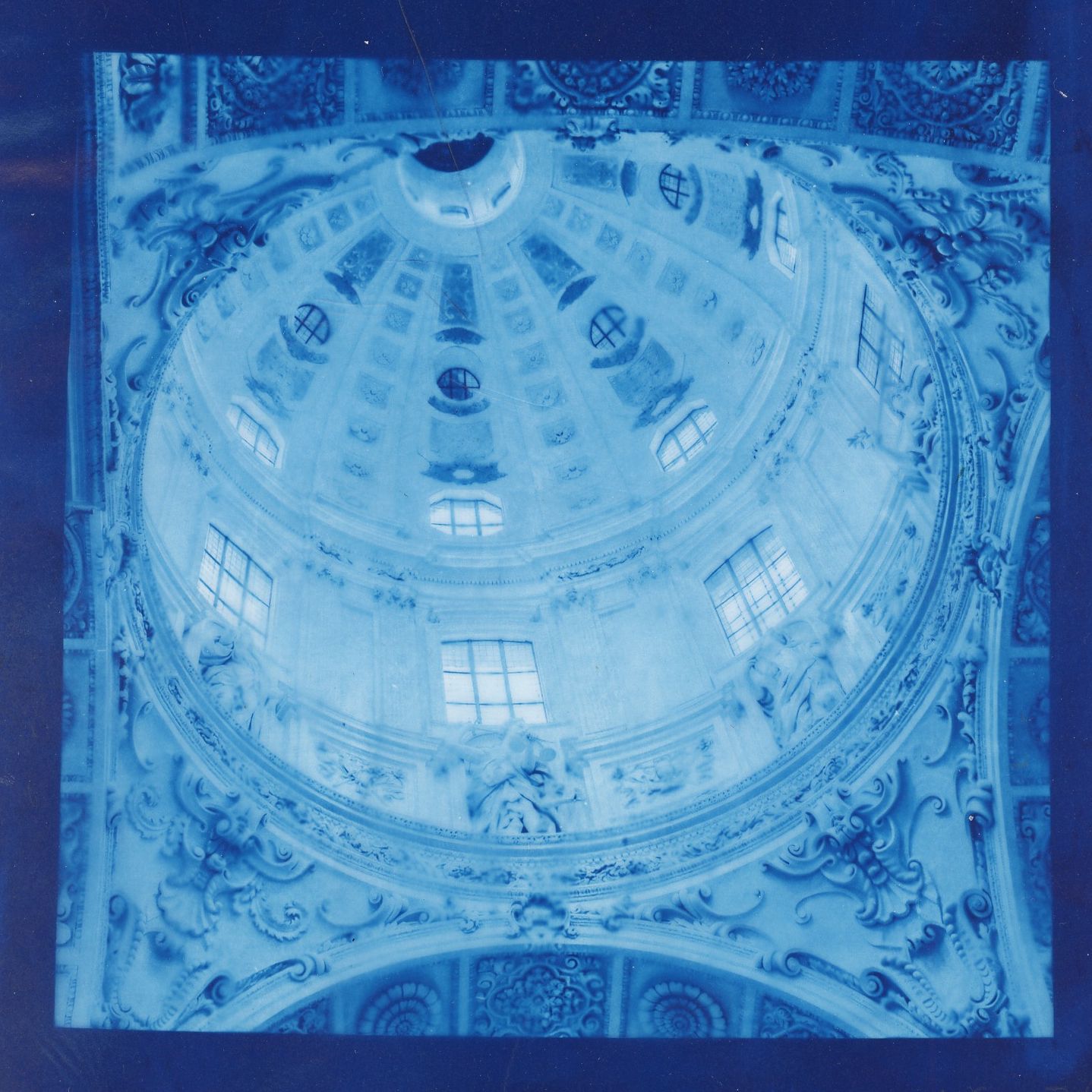

I tried to make a cyanotype on the vellum and it kept rolling up, and was difficult to dry - I need to find a way to fasten it down while drying - I was able to flatten it a bit after drying but when I printed it ( I have a print frame that allows a lot of pressure) I have some blurry streaks in it - so I need to find a way to dry it flatter and them try it in my press.

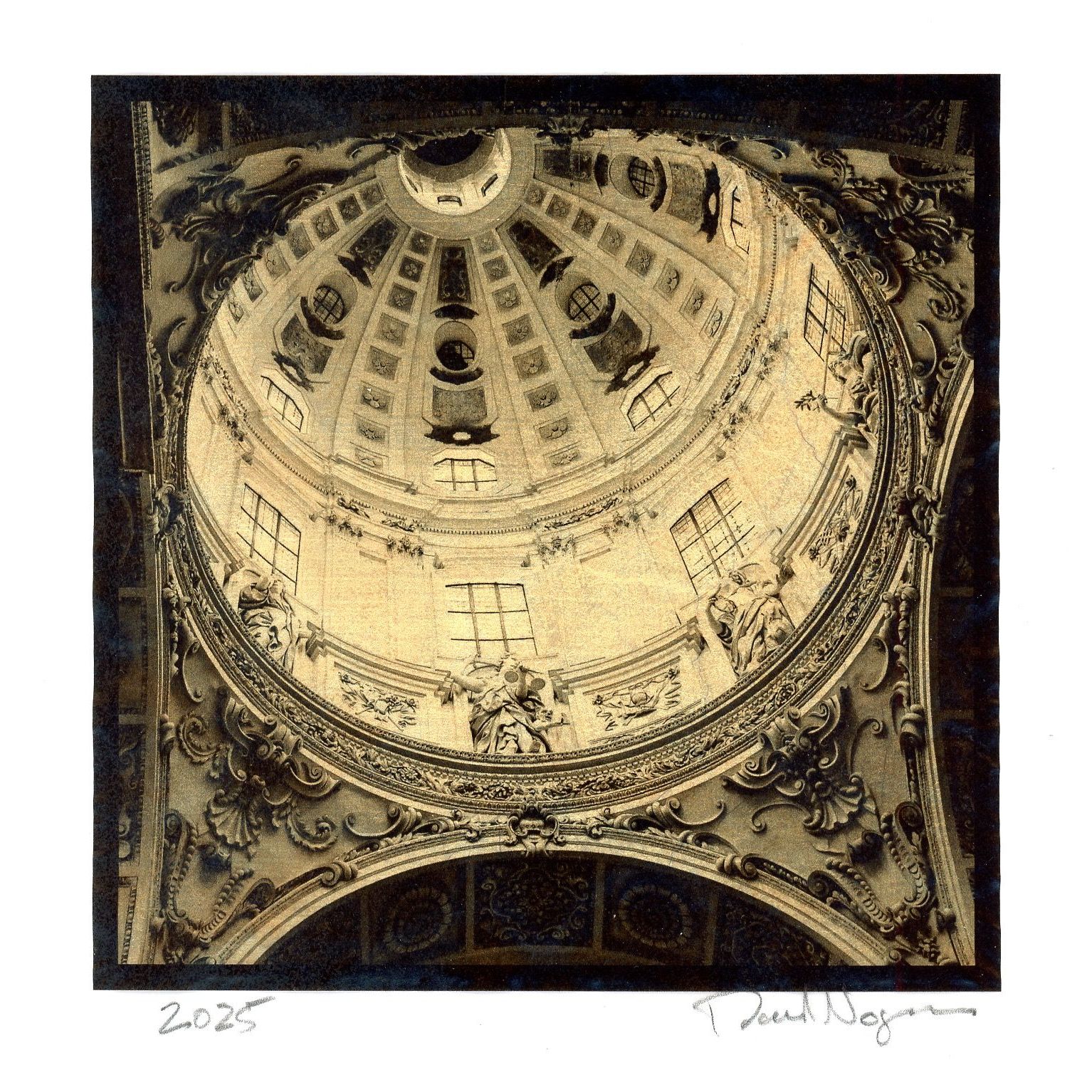

Attached is a gilded inkjet print on vellum ( the inkjet print also had some wrinkling but was fairly easy to flatten), varnished and gilded. I really like it but my application of the sizing to attach the gilding had streaks and they show if you look closely. The second is the same image on vellum as a cyanotype - not terrible but if you look there are blurry areas where the negative was not incontact with the vellum. I will plan to print this again as a cyanotype, taking care to dry it flat ( taping it to a sheet of glass) and seeing if that helps.

That looks very nice. Some time ago I was playing around with dry-mounting the vellum on a acrylic sheet or glass first with a low temp reversible adhesive tissue which can be re-heated to remove the print at the end of the process. People used to do this to improve registration in a multi-layer process. Something to try in this instance too.

Yes I apply the varnish to both sides, and it make the vellum quite translucent, such that when the gilding is applied to the back side it really shows though in the highlights. This was part of the gilding kit instructions. I like the wax idea as well.
The varnish actually creates much less wrinkling than the "sizing" used to adhere the gilding, which appears to be PVA adhesive and is water based. I think I will try a spray adhesive (3M mounting adhesive) which is solvent based - that may create less wrinkling. It seems that any water based surface treatment causes problems. - I will try a couple of different approaches to this to see what works best - again thanks for everyone's comments. I am off trolling e-bay for a reasonable dry mounting press - I think it will be very useful for my other alt photo works.
