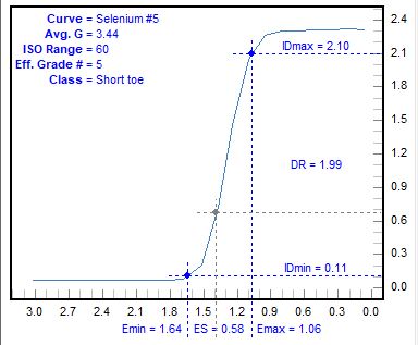

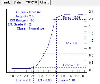

As far as the VCCE capability, I just completed some paper curves and have seven paper speed points (one for each whole number filtration setting used from #00 to #5, there are in between settings as well) that I've been looking at. Lately, I'm trying to learn more about paper sensitometry, I know most don't give a rip about it but I've never tried to learn as much about it as I've tried to learned about film curves. I learned that the speed point is a point on the curve at a density of 0.6 over the b+f density of the paper, follow a line down to the log exposure range to note the log exposure of the speed point. I've also learned that the VCCE performance will not be perfect in it's ability to speed match between filters......there will be some fudge factor. So I've wondered how much of a fudge factor.
In an effort to look at the VCCE performance of my LPL, the question I have is......should the log exposure speed points be the same for each filter since the VCCE's job is the try and speed match the exposure times between filter changes. It may not be a valid question, but it's something I've been thinking about as I try to learn more about it, maybe those that know will chime in.
I've noted that for the seven speed points I have (for the paper I've toned in selenium), the fastest i.e., the further left on the horizontal axis, is a log exp of 1.68 for the #2 setting. The slowest i.e., the further right on the horizontal axis, is a log exp of 1.39 for the #5 filter. That's a log exposure range between the fastest and the slowest of 0.29. My question is, does that difference represent the difficulty of the VCCE head to more exactly perform speed matching between filters, if so, it's still a pretty tight range, imo. I'm not even sure these curves are able to do the job of telling me about the VCCE performance of the enlarger, but it's a question I have. Here are the #2 and #5 (BTZS Plotter generated) paper curves. Ignore the curve name for #2, it is also toned in selenium.
