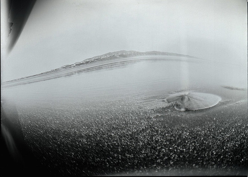

I think uneven development or streaking and mottling can be a problem with very dilute developer. A good presoak, making sure the water covers the paper quickly and without droplets or splashes can help. Then the same thing going smoothly and quickly into the developer, with continuous agitation... the agitation does not need to be vigorous, but it should keep fresh developer moving over the whole negative. Even being careful, sometimes it still happens... I don't know the cause, whether it's "bromide drag" or "surge marks" but sometimes there will be a streak of uneven development and it often starts at a boundary of dense / not dense.
I'm sure I developed this carefully, but look at this steak and mottling in the sky:
Pinhole Sand Dollar by Ned, at ipernity
I think those specks might show up more when you scan a paper negative that is a bit dark to begin with, so that there is not a lot of contrast and it's all bunched up in the darks ( the histogram is bunched up to the left ). Then, either the scanner software or whatever software you are using makes the specks stand out more when you add contrast and try to get dark enough blacks on the inverted version. They might also be related or increased by texture on the paper: I like to use pearl surface paper and it might be more prone to speckles in scans.
Don't get discouraged, you're getting it!
